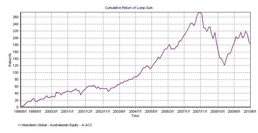

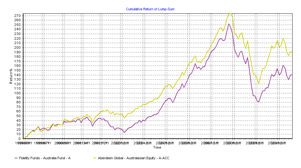

After install Teechart v2010.01 Prelease, the bottom axis of teechar become very strange.
the bottom axis's label is overloped.
as attached file
Teechart 7.gif:original chart
Teechart v2010.01 VCL non-stable prelease.gif: after install Teechart v2010.01 Prelease.
Daniel

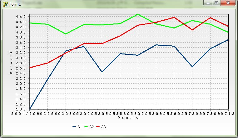

Here's a screen-shot of what I get using our current 2010 sources:
Is this what you get? If not, you may expect the issue to be fixed for next maintenance release.

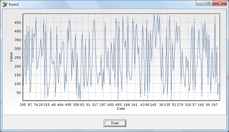

Hi:
Teechart VCL v2001.01 is really unstable.
Lables of bottom axis overlaps.
Image and sample program is attached.
When will stable maintance release launch?
Daniel
Daniel

Re: Strange Bottom Axis
Hello Daniel,
I suggest you change labels alignment of your bottom axis, so it are not overlapping. You can use next line of code for change it:
I have checked it with last version TeeChart VCL and works for me.
I hope will helps.
Chart1.Axes.Bottom.LabelsAngle:=90;
I hope will helps.

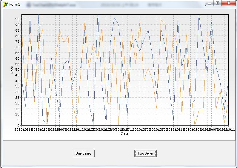

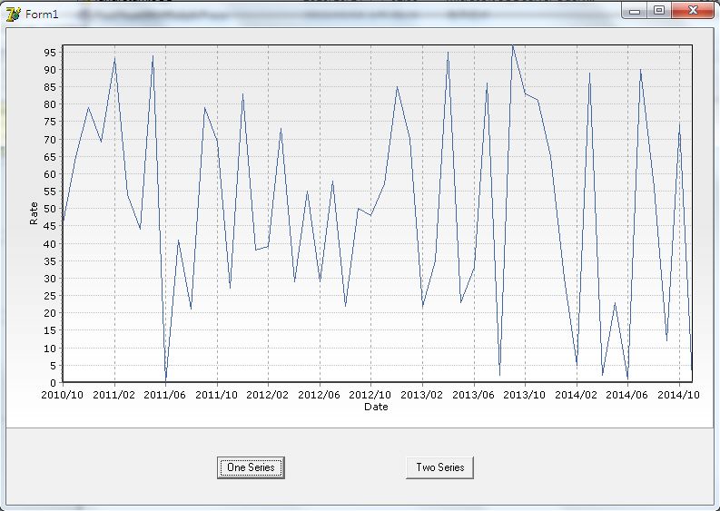

I have upgraded to the latest version of TeeChart VCL.
TeeChar Version:October 05, 2010 Build 2010.01.11004
Delphi 7
Window 7 64 bit.
I have atached a sample program.
If you click one series the chart works fine.
if you click two series you can see the label of bottom axis overlape.
Daniel
Delphi 7
Window 7 64 bit.
Daniel
Hi Daniel,
After investigating the issue in Draw.zip further we came to the conclusion that this is not a bug. We found that in your project you had set bottom axis LabelsSeparation property to zero, thus no label anti-overlap calculation is performed. Setting LabelsSeparation to default value (10%) works fine:
Chart3.Axes.Bottom.LabelsSeparation:=10;
