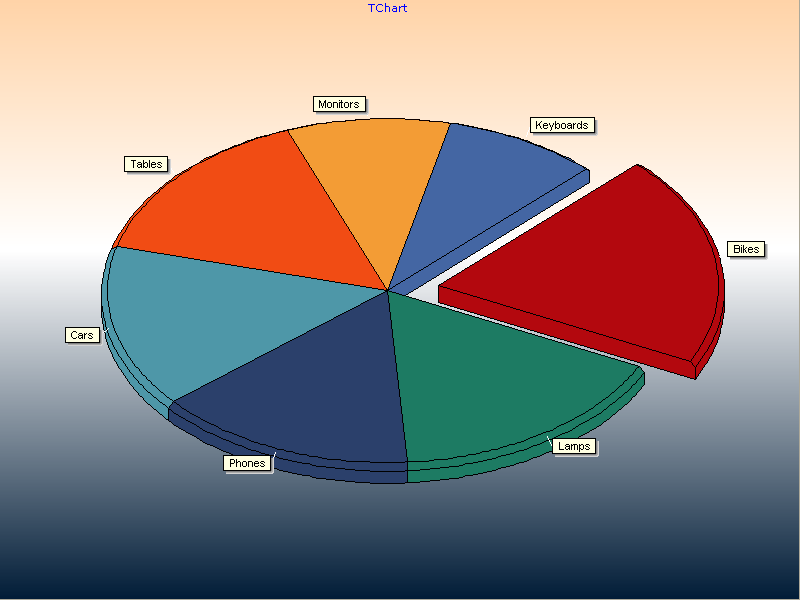

I've attached my result.
As you can see your image has some differences:
1. Lines between pie's slices has the same color as the slice itself.
2. Lines and color are more smooth.
3. The image has some effects (lighting, gradient or filter)
And I've found the same post at ActiveX forums Pie Chart Drawing.
Can you give me the sample of source code (for Delphi7) so that we can make such effects.

This example in the gallery was created using TeeChart for .NET so there will be rendering differences between VCL and .NET versions of TeeChart. However, TeeChart 2010 has been improved to plot similar charts as you can see at the "What's New?\Welcome!\New in Series\Pie Lighting" example in the new features demo available at TeeChart's program group.
Hope this helps!
