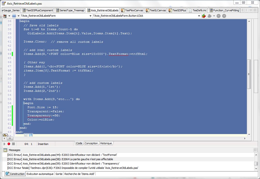

My version is 2010.01.11004 but the project Tee9New.dpr don't is not compiled. For example this procedure failed to compile with errors as you see on the screenshot join
procedure TAxis_RetrieveOldLabelsForm.Button1Click(Sender: TObject);
var t : Integer;
with Chart1.Axes.Bottom do
// Save old labels
for t:=0 to Items.Count-1 do
OldLabels.Add(Items.Item[t].Value,Items.Item[t].Text);
Items.Clear; // remove all custom labels
// add html custom labels
Items.Add(0,'<FONT color=Blue size=15>000').TextFormat:=ttfHtml;
{ Other way
Items.Add(1,'<b><FONT color=BLUE size=15>1st</b>');
items.Item[0].TextFormat := ttfHtml;
// add custom labels
Items.Add(1,'1st');
Items.Add(2,'2nd');
with Items.Add(3,'etc...') do
Font.Size := 15;
Transparent:=False;
Transparency:=50;
Color:=clBlue;
var t : Integer;
// Save old labels
{ Other way
Items.Add(1,'1st');
Items.Add(2,'2nd');
Font.Size := 15;
Transparent:=False;
Transparency:=50;
Color:=clBlue;
There is others problem with GDI+
Best regards

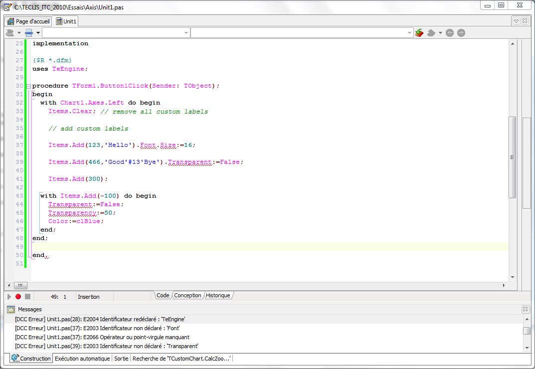

I join a sample program where the example don't work.
Best regards
Gérard.
Best regards
Gérard.
- Compiler answer
- Capture2.JPG (101.33 KiB) Viewed 9680 times
- Axis.zip
- Sample
- (9.28 KiB) Downloaded 549 times
