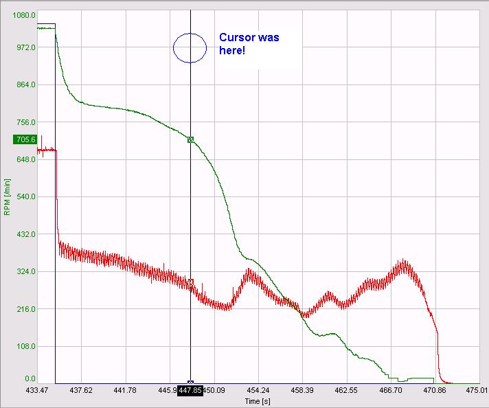

I think we misunderstand each other.
As seen on the enclosed screen shot (from a measurement program I'm about to "copy") I want to get the YValue that is on the same horizontal position as the cursor, but not necessarily on the same vertical position.
You wrote:
>>You can also obtain the pixel for a determinate series' value, knowing it's index in the series:
>>XPixel:=Chart1[0].CalcXPos(10);
My question is now:
How can I obtain the Index of the YValue in the series?
Do you get it?
My question is now:
Do you get it?
