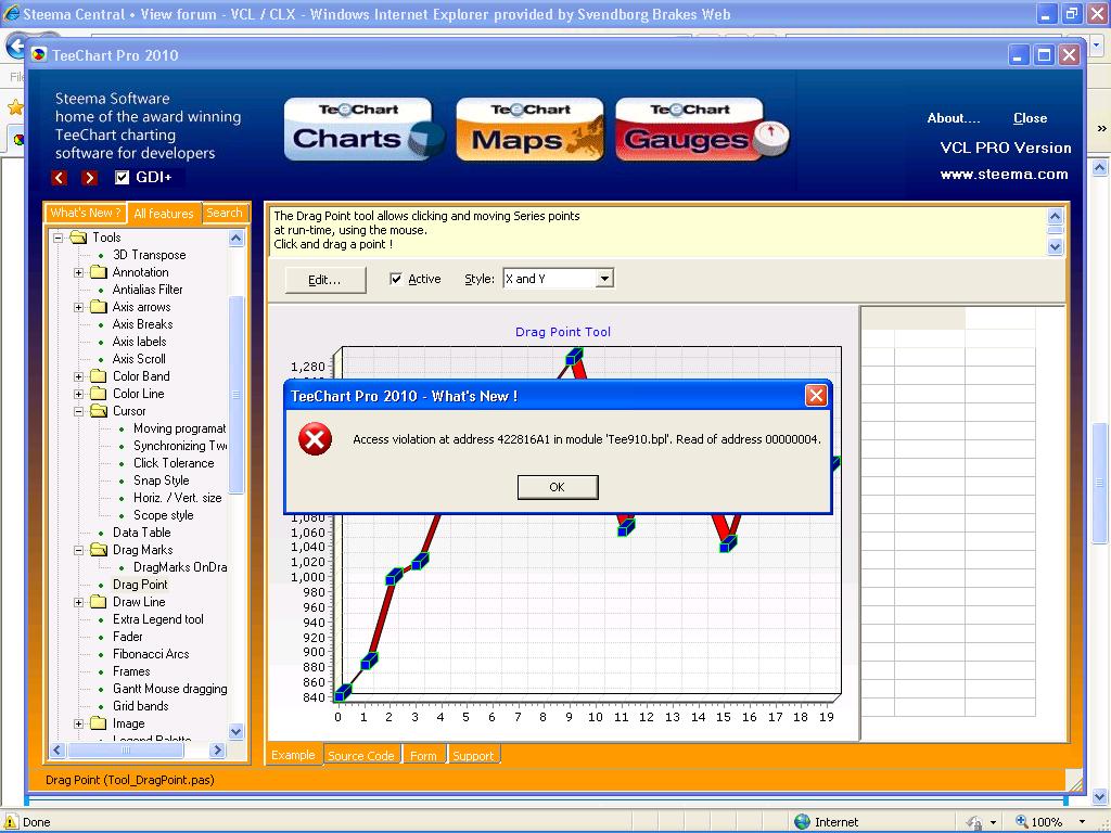

I get an Access violation when clicking the Drag Point tool in the TeeChart 2010 demo.
Just for your information.
- Access violation when clicking Drag Point.JPG (152.1 KiB) Viewed 10889 times

Hi ChartIt,
I cannot reproduce it, but there is another error in this demo.
When I click the line between point 2 and 3, it selects point 1.
This is consistent for all lines: cliking the line between point x and x + 1, selects point x - 1.

Hello everyone,
I can't reproduce any of those here using our current sources. Code snippet below works fine for me here. Can you please check if it works fine at your end? Can you modify it so that we can reproduce the issue here? If you are TeeChart 2010 VCL source code customers I could provide our latest sources for you to test.

Hi Narcís,
Bert
Did you check thisI can't reproduce any of those here using our current sources.
with the demo application on the website? Maybe it's time to update it.When I click the line between point 2 and 3, it selects point 1.
This is consistent for all lines: clicking the line between point x and x + 1, selects point x - 1.

We've updated the compiled features demo here recently. I can't reproduce the error in the first post and neither the problem with the indexes.
Could you please confirm it?

My issue has been solved in the new demo, but you might update the text on the website:
BertTeeChart compiled demo
version : 2010 / date: June 01, 2010

Hi Bert,
Thanks for pointing this out. I have updated it to 17th November 2010 which was the date when I posted the current demo.
