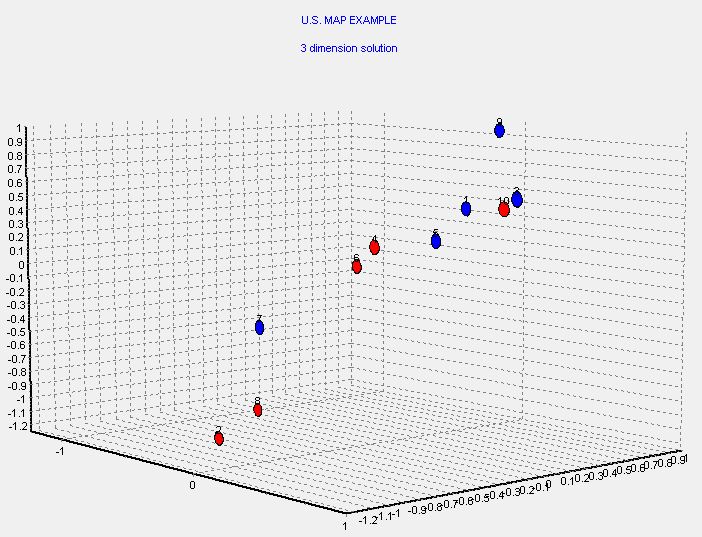

Let me explain why those last two are important. (SEE THE ATTACHMENT.) I built this chart using a Bubble3D series with some sample data. With the RotateTool hand, I manipulated the chart until I discovered that all of the points lie near a plane that cuts through the 3D display at oblique angles. This is exactly the kind of discovery that scientists, statisticians and others use spin plots for! The mostly likely next step a user would want would be to see the points looking down perpendicularly on that plane. If I had a way to do a "roll" on the points AS SHOWN it would be an easy matter to "tip" them until they line up horizontally and then "pitch" until I'm not looking down on the flat plane (which is oblique to the original axes).
Can you please explain exactly how we do for reproduce it? So we can try to help you to solve it.
