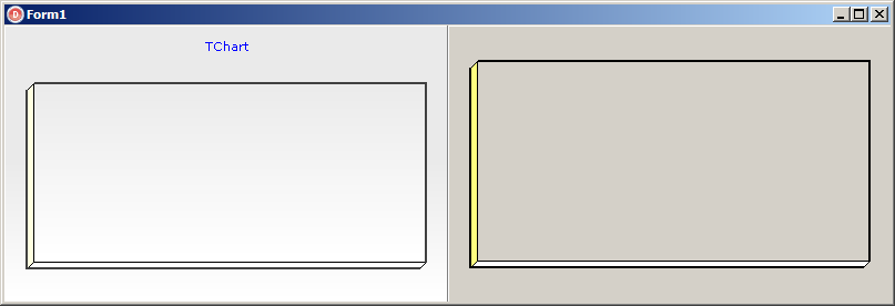

Setting the Panel color has no effect. As near as I can tell, keeping the gradient visible, and setting the start and end colors is now the way to set the background color. Attach is a screen capture of what charts default to at design time (left) and dynamically created at run time. To return my dynamically created charts to what they were before, I'm now adding the following code:
Chart2->Gradient->Visible = true;
Chart2->Gradient->StartColor = clBtnFace;
Chart2->Gradient->EndColor = clBtnFace;
- Design vs Dynamic created charts
- TChartDesignVsDynamic.png (50.42 KiB) Viewed 21846 times

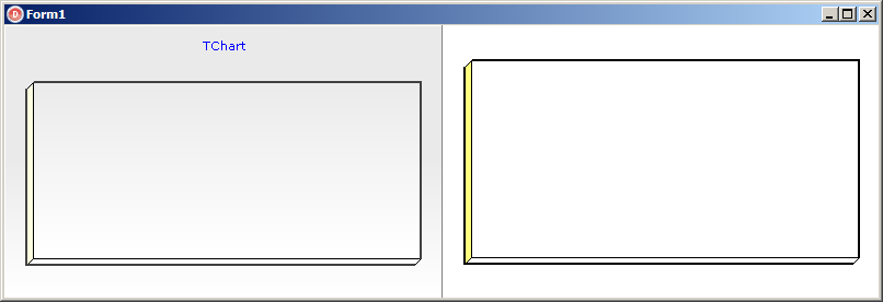

After investigating this we've concluded that it's not a bug.
In v2010 we wanted to give a better look to the new charts adding a gradient to the charts created at design time. However, we didn't want to change the aspect of the charts created at runtime to ensure backwards compatibility.
On the other hand in v2010.02 we found a related problem (TV52015430: "The back color (color of the panel) seems not to respond to the Chart.Color property"). This problem in v2010.02 has been recently solved
With v2010.02: With the TV52015430 fix: The fix will be available with the next maintenance release.
To create a "designtime looking" chart at runtime, you should set some properties manually:
