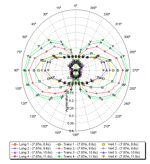

I have a migration issue which I hope you can help with. We have a legacy BDS 2006 C++ builder project which also used TeeChart 7.08 components to create a polar plot graph. We have migrated the project to RAD Studio 2010 and TeeChart v2010 VCL.

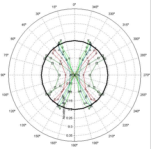

Below is the good polar plot from BDS 2006/TeeChart 7.08 (ignore the squashed effect, this is due to a remote connection) The problem I now have is that all points on our polar plot now appear on the zero degree line, that is they are scattered between the origin and the top of the polar plot. Are there any changes to the components in the intervening versions that could account for this behaviour, or is there something I could check for in our code that may be causing this effect?

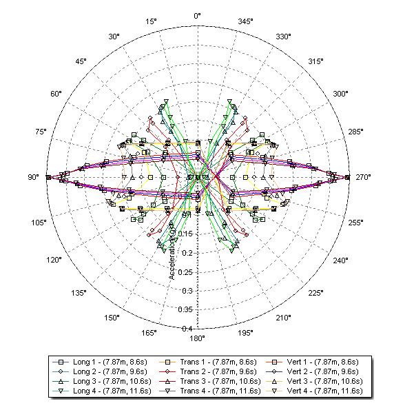

Below is the incorrect result in RAD Studio 2010/TeeChart v2010 VCL Additionally, the colours of the series have changed, even though we have not changed any code to do this.
Steve Chamberlain.

Ok, it seems updating to the new version did not help, so I am assuming it is something to do with our code. We have been using the AddXY method to add points to our polar series and I have now been experimenting with AddPolar with differing results. Is this the correct way to be adding points to the polar series?

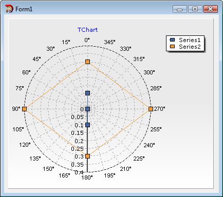

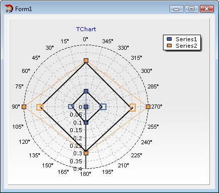

I am still having trouble with this. I have created a small project to demonstrate the issue.
In the code, I add some values to two series:
Series1->AddPolar(0, 0.1);
Series1->AddPolar(90, 0.1);
Series1->AddPolar(180, 0.1);
Series1->AddPolar(270, 0.1);
Series2->AddPolar(0, 0.3);
Series2->AddPolar(90, 0.3);
Series2->AddPolar(180, 0.3);
Series2->AddPolar(270, 0.3);
Neither of the resulting series give me what I expect:
I have (admittedly crudely) photoshopped my expected result over this screenshot (I just used black lines for illustration, they should be in the same colour as the series of course):
I hope this helps, I really need to solve this soon.
Steve.

Hello Steve,
It only seems to me a question of axis setup. If I add the following to your code I think it looks as you want:
Note that at design time you've forced Left axis (vertical axis in TPolarSeries) to automatic=false, minimum=0 and maximum=0.4. With the code above I force the same for the Bottom axis (horizontal axis in TPolarSeries).
Chart1->Axes->Bottom->SetMinMax(0, 0.4);

However, when I apply this technique to my main chart, it is improved, but still not correct: It looks like the lines are joined incorrectly; do you maybe have any theories about what could be incorrect here? I can't send you the code for this production chart unfortunately, but all suggestions are most welcome!

Thanks for the tip, changing the axes have definately helped (all points are at least inside the polar plot and not outside). However, it still hasn't solved the issue (see the previous post's screenshot, or the coloured series in the following screenshots).

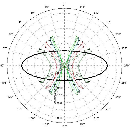

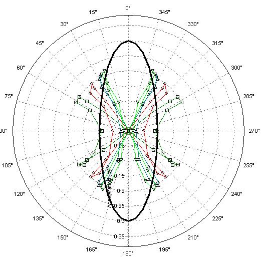

I added a simple black ring to the graph using another polar series. The radius value can be changed dynamically in the application.
When this ring is drawn, the point coordinates seem to be adjusted proportionally somehow. The series is set to circled and each point is added at the same radius value, so I expect to see circles, instead I see ovals when the radius value is 0.1 or 0.3 and an approximate circle at radius 0.2:
Is there some way to disable this proportional effect and just draw the points exactly as I specify them?
Steve
Steve

Hello Steve,
I'm trying to reproduce it with the attached testing application but it seems to respond as expected.
Could you please take a look at it to try to find out what are you doing different than me? Please, try to modify it so we can reproduce the problem here or please, try to arrange a simple example project we can run as-is to reproduce the problem here.

Finally solved! I had to make several changes to get it to work, but my polar plots now look as they should. Setting the left and bottom axes to automatic did the trick. The other problems I had drawing the series were to do with a change in our code, so now everything is behaving as it should.
