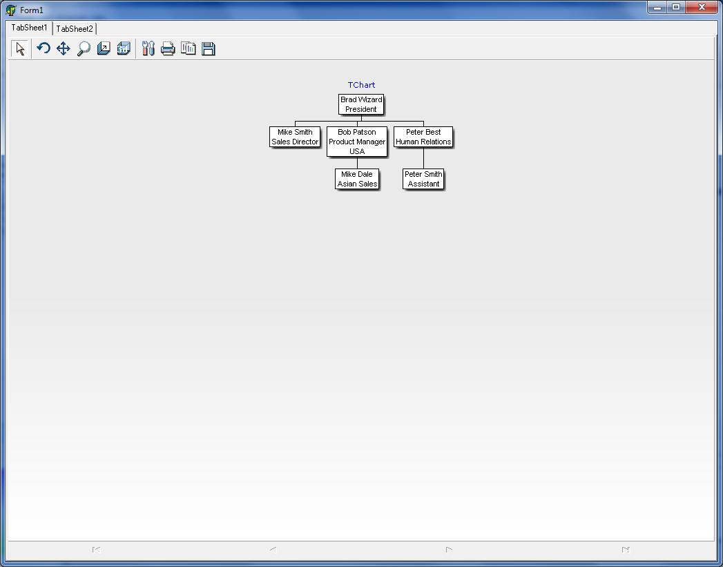

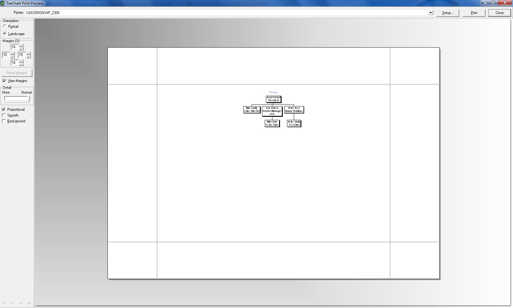

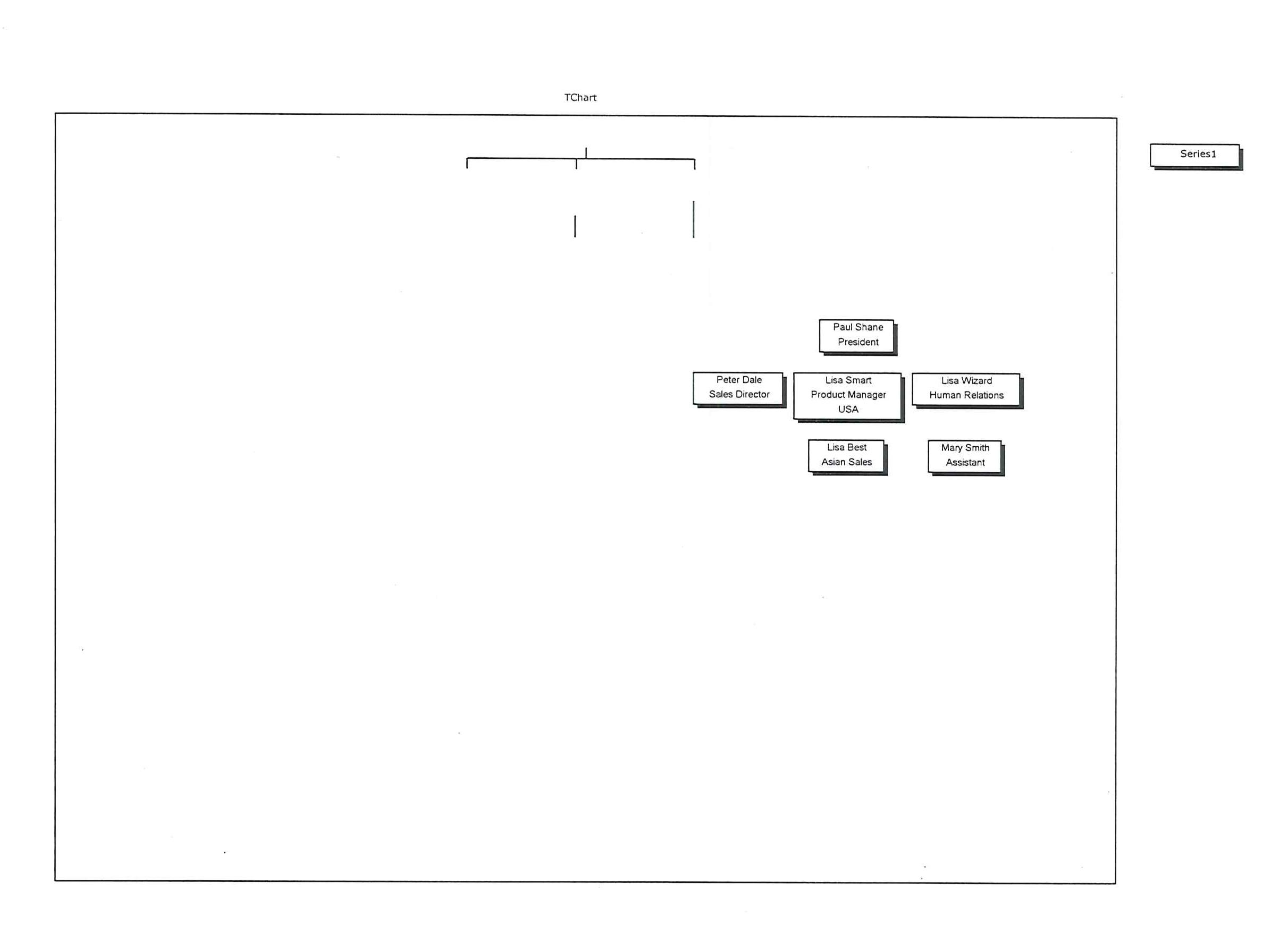

Created an empty project in Delphi with one Chart, and added an Org series to it. With random data the Org series prints wonrg - the boxes are misplaced. See the attached images, for how they are printed wrong. First image is a printscreen from the application, second is the print preview, third is the printed paper scanned.
Can anyone help me how to fix this?

Hello Peter,
You are right. I've added it to be fixed in future releases (TV52015576).
But as said here, the StretchDraw method seems to workaround it.
