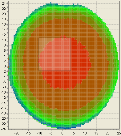

thank you very much for your reply. The TContourSeries we use to have good pictures of our date. Internaly we use the xyz-triplets. Therfore we have to know witch xz-point is in a user controlled area of this series. The user can alter the size and position of this are and than we had to compute e.g. the histogram of all y-values of all points in this area. Therefor we us the TRectangleTool now to draw this area. My question is, how can i detect if a point from the series is in this rectangle, and than i will add this point to a list or a second sere to compute the date.
I will you sen a picture of a sample 2D Contourseries with a TRectangleTool. The purpose is to compute e.g. the mean value or other statistical values from the z Values from all points in the area of TRectangletool.

Re: TRectangleTool and TContourSeries
Hello Willi,
Thanks for the explanation and the picture. It clarifies the problem a little bit.
Taking the code another customer shared here, I made an example of how you could get the list of a TContourSeries indexes under a TRectangleTool:
Note I'm highlighting the values found under the rectangle but you probably only want the TIntegerArray returned by the GetPointsFromRect function (selIndexes).
