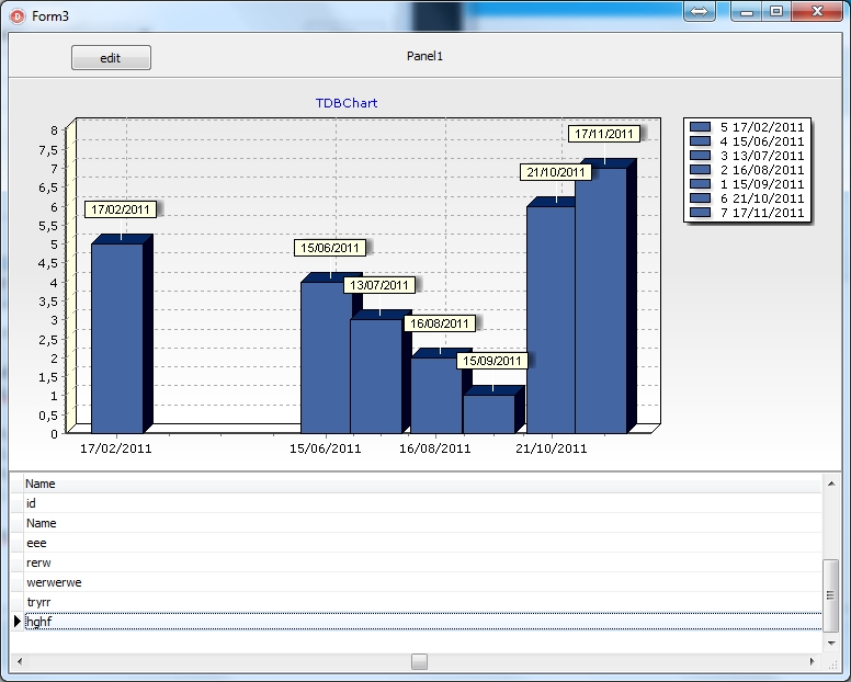

I have a series grouped by month.
I want it to sorted correctly.
How?

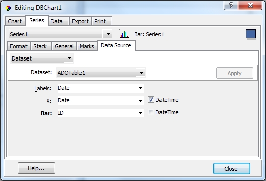

If you go to the Series -> General tab how are series sorted? You should try sorting them by text. If the problem persists could you please attach a simple example project we can run "as-is" to reproduce the problem here?

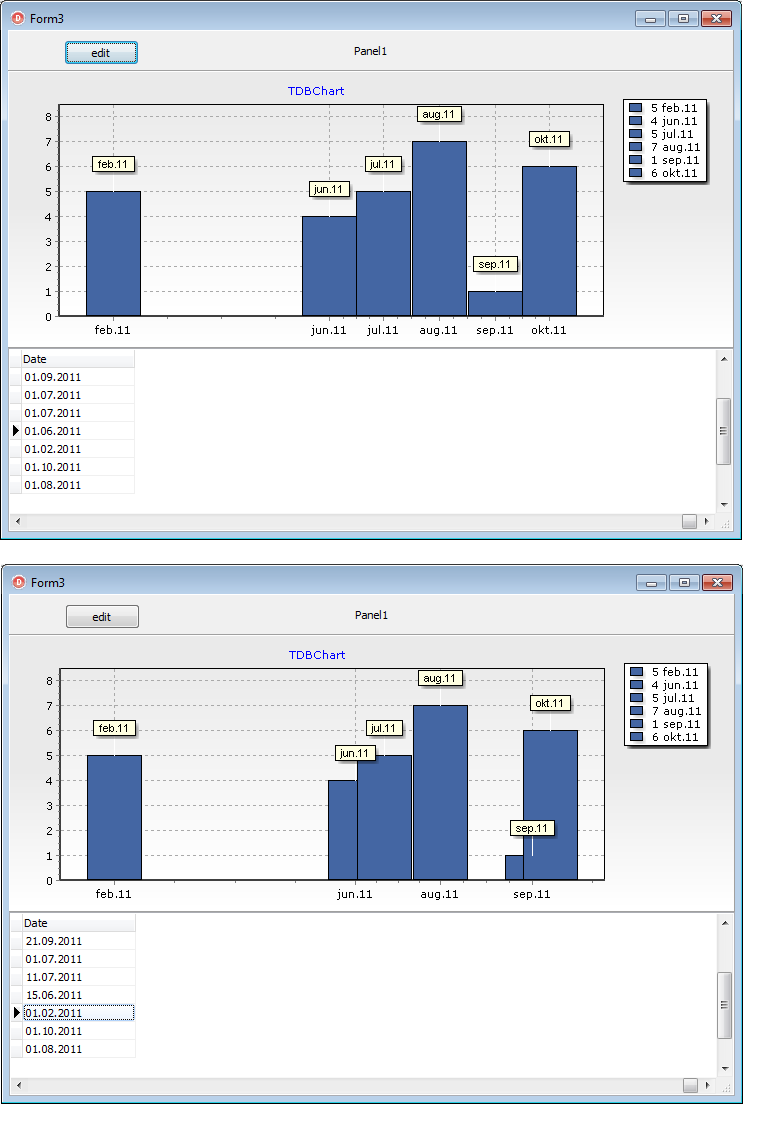

Think it is tha same for me if it is first, midle or last day in the month, the problem is that it doesn't work like this for me. It uses the actual date. Take a look at the second image.

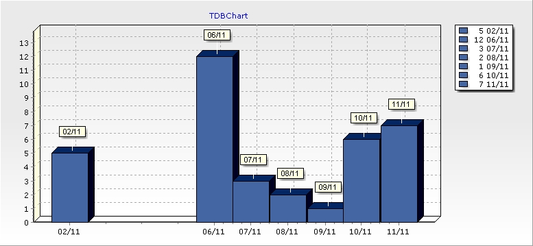

Which produces this chart:
Is that what you expected? Notice there are some more DateTime grouping options now.

This is exactly what I want,
