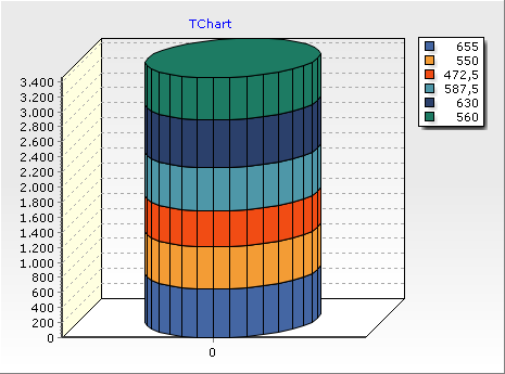

I'm afraid the smoothed curves is one of the GDI limitations.
Here you have the results I get with GDI, GDI+ and GDI&AntiAliasTool.
  Chart1.Chart3DPercent:=100;
    FillSampleValues();
    BarStyle:=bsCilinder;
    MultiBar:=mbSelfStack;
    Marks.Visible:=false;

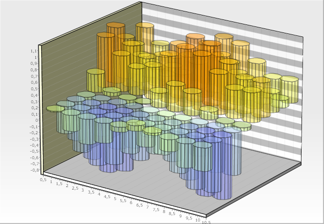

But how was this chart
created? This is an example from the steema gallery. Theses are also cylinders but they look very much better than the regular cylinder bar chart. Using the regular cylinder bar chart one have very few options to change the look of the cylinders. E.g. using a gradient fill.

This example from the gallery was made with TeeChart .NET and some of Micrsoft .NET Framework drawing techniques are not available in the VCL framework.
However, with GDI+ and the following code I get a quite similar result:
uses TeeSurfa, TeeGDIPlus, TeeTools;
  with TTeeGDIPlus.Create(self) do
    TeePanel:=Chart1;
    Active:=true;
  Chart1.Title.Visible:=false;
  Chart1.Legend.Visible:=false;
  Chart1.Aspect.Orthogonal:=false;
  Chart1.Aspect.Zoom:=70;
  Chart1.Aspect.Rotation:=325;
  Chart1.Aspect.Elevation:=340;
  Chart1.Walls.Left.Size:=10;
  Chart1.Walls.Bottom.Size:=10;
  with Chart1.Tools.Add(TGridBandTool) as TGridBandTool do
    Axis:=Chart1.Axes.Left;
    Band1.Color:=clGrayText;
    Band1.Transparency:=50;
    Band2.Transparency:=50;
  with Chart1.AddSeries(TTowerSeries) as TTowerSeries do
    FillSampleValues();
    Origin:=YValues.MinValue+(YValues.MaxValue-YValues.MinValue)/2;
    UseOrigin:=true;
    TowerStyle:=tsCylinder;
    Dark3D:=false;
    Transparency:=30;
    UseColorRange:=false;
    UsePalette:=true;
