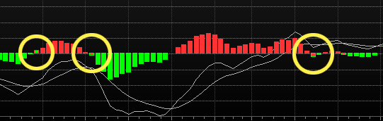

I'm using TFastLineSeries and TBarSeries to implement a MACD chart.
I tried to paint bars with different colors in BarStyle Event but the SeriesColor property
is wrong every time the bar direction invert.
How can I correct this problem? thank you.

Post by Yeray » Tue Nov 29, 2011 12:41 pm
Right, when OnBarStyle event is executed, the brush color is already assigned for the current point so it doesn't take effect until the next point is going to be drawn.
Why don't you set a color for each bar in the series ValueColor array? With it, you only have to set the pen color at the OnBarStyle event.

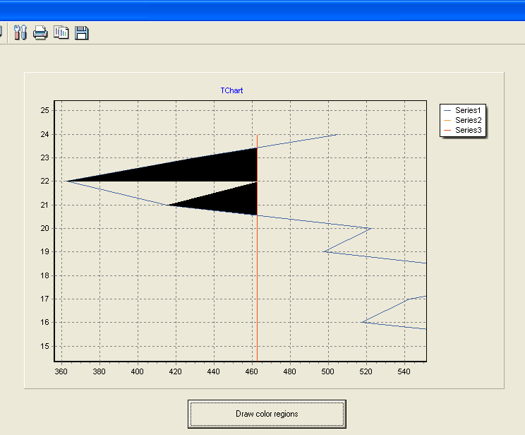

Thank you very much for this. I tested it here under D2007 and TeeChart 2011.03.30407 and is some cases it does not work as expected (see attached picture). Can you please confirm this?
Re: A problem with bar color, please help.
Post by Yeray » Tue Dec 13, 2011 9:27 am
johnnix wrote:I tested it here under D2007 and TeeChart 2011.03.30407 and is some cases it does not work as expected (see attached picture). Can you please confirm this?
Right. There was a problem in the CrossPoints function (concretely at TCrossPointsFunction.AddPoints method) that was giving some wrong points. I've just revised and fixed it for the next maintenance release (TV52015960).
