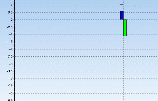

I have seen many topics related to this Error. I can see difference between plots in previous releases and the latest release 2011.04.41118, so something is done but problem is still there in a different way.
Problem:
For bars having negative values only the "Bottom" Errorbar" is ploted despite that I use the essTopBottom option. Please see the attached image. I am using the TErrorBarSeries.
In the previous releases "Top" or "Bottom" was ploted randomly, but not both as I wish to have.
BR

- bugg.jpg (23.37 KiB) Viewed 7415 times

I see the behaviour with this has changed between v2010.00 and v2010.01, and then again between v2011.03 and v2011.04.emwamin wrote:I have seen many topics related to this Error. I can see difference between plots in previous releases and the latest release 2011.04.41118, so something is done but problem is still there in a different way.

Hi.
In the following post the same problem is mentioned:
http://www.teechart.net/support/viewtop ... bar#p49684
it says:
The error value "E" should normally supposed to be E > 0. But if Y < 0, then with E > 0 the half error bar is drawn below the point, inspite of the "essTop" setting.
And the respond was:
Ok, I fixed this one (TV52015187) too.
I was running on Verion 8 before upgrade and I could see the same problem.

The issues mentioned in the thread you mention were fixed in TeeChart 2010/2011 as you can see in the version info page. Could you please attach a simple example project we can run "as-is" to reproduce the problem here?
