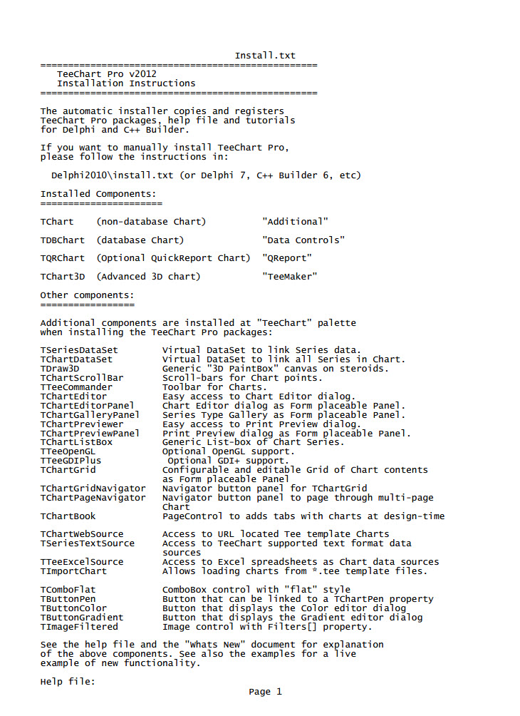

I don't have the TChartGrid component any longer and cannot compile
I have all of the original distributions, but I don't know how to install the TChartGrid and related component which came with the TChart Pro 9 components.

I got it working.
I uninstalled the source code version and installed the binary version (TeeChart2012RADXE2.exe), and the TGridChart component is available.
This tells me that the installation procedure for the source code distribution has a problem and needs to be examined (TeeChart2012SourceCode.exe).
I would prefer to see better / more informative manual build / install instructions if that is possible. This would certainly reduce frustration. It is possible that the file 'Install.txt' (dated 21-Mar-2012) is out of date, or could benefit from additional steps in the detail. The end result from a source code install does not match the content of that document (copy attached).

- InstallTxt.jpg (322.88 KiB) Viewed 9131 times
