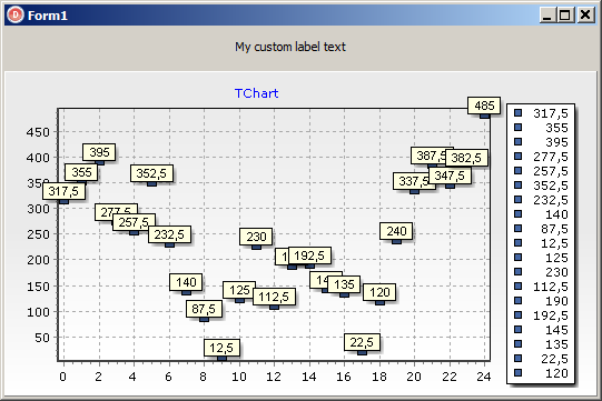

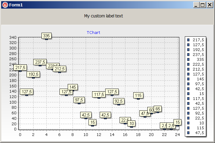

in your attachments there is form.scaled to true
setting it to false give me this
as you see with 120dpi the label "My custom label text" is alway the same dimension as 96dpi, the marks and the legend of the chart instead grow.
