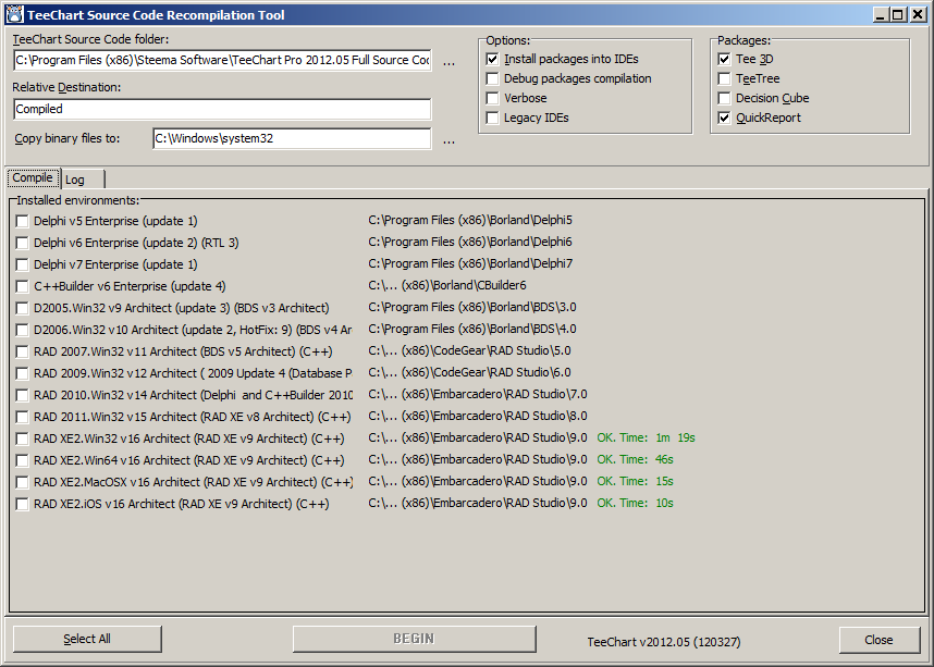

I use the recompile tool and check out for install TChart3D , but it is not.
any reason?

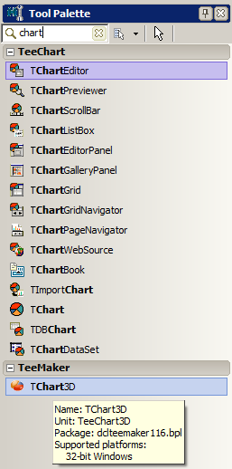

What TeeChart version are you using. Here with TeeChart v2012.05 I see the TeeMaker component installed in XE2:
And I see the TChart3D component in the palette:

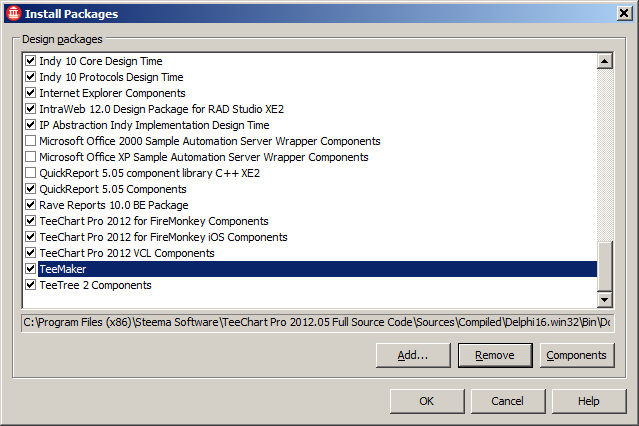

if i install ttree tmaker is also installed
I don't want to install ttree

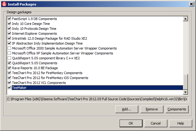

Selecting "Tee 3D" (and not "TeeTree") in TeeRecompile:
Installs TeeMaker for me here and not "TeeTree 2 components" as in the post above:
Doesn't it do the same for you?
