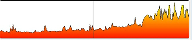

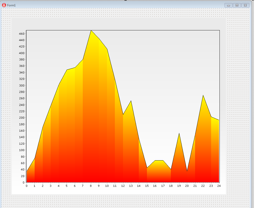

I have just updated to version 2011 from 8.07. In the old version I had an AreaSeries with a gradient starting on red and ending on yellow, which gave a very nice "red mountain" like picture. However, in the new version I get some strage vertizal zones (see attached image). Any advice on how to remove these zones and get a "continuously" image like the old version will be highly appriciated!
Best regards Jorgen

Hello Jorgen,
It is known feature requests for us with number [TV52014958] where we consider add a property GradientRelative property for TAreaSeries as in TeeChart for .NET to achieve as you want.

Thank you so much for answering. I have users of my software who definitely will complain about why I have changed the layout. Is there any other series whereby I can achieve the same effect as shown in the attached image?
Thanks for helping
Jørgen
Thanks for helping
Jørgen

Hello Jorgen,
Sorry for the delay. I am afraid this problem appears in all series and we try to consider the feature request at upcoming maintenance releases. On the other hand, to achieve a similar effect with the image you have attached, you can use Series region Tool. You can find an example in Demo project All Features\Tools\Series Region.
