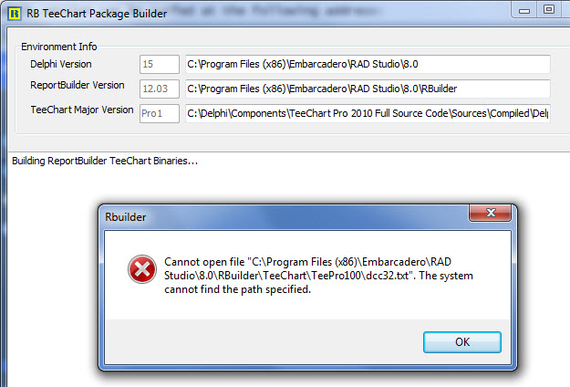

I had installed TeeChart in the default c:\Program Files X86 directory structure - but when I tried to compile anything that used TeeTools - it told me that I could not compile that file. I guess it was an issue with the c:\ProgramFiles redirection in Win7 - so I uninstalled and resinstalled it into a new directory c:\delphi\...
It installed fine - but when I tried to install the Report Builder components - I get an error. It tells me that it cannot open file dcc32.txt in the c:\Program Files(x86)/... directory structure. And of course it is correct - because it is not there.
Yet in the TeeChart directory int he RB TeeChart Package Builder - it shows the proper directory of c:\Delphi\...
Have you ever seen this before? I know this is a RB issue - and I will be asking them as well - but Ithought I would also check here incase therewas an issue with a registry entry or something similar.

- Error Message when installing RB
- TeeChartRBIssue.jpg (88.65 KiB) Viewed 8585 times
