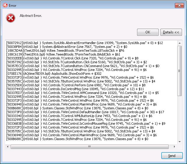

When I try to add a subchart in the TChart Editor I get the following message.

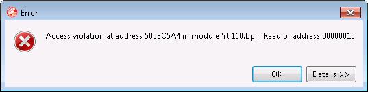

And when closing this window I get
