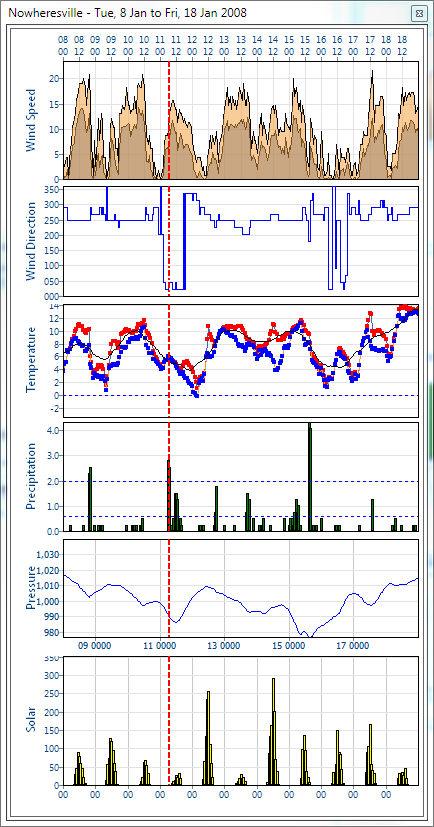

I want to stack six charts vertically on top of each other. All the charts are for the same period and I have added a vertical chart tool to each chart to show the selected time. This works fine but the labels on the left axis are always a slightly different width so I can't alight the left wall of each chart. I have tried setting the panel width both by pixel and percentage but with no luck can anyone give me a clue?
The other thing I would like to is disable the labels from the 'inner' four charts but still show the grid. This too seems impossible - all I want to do is show the grid without either the bottom or top labels.
Bruce
Here is a screenshot:

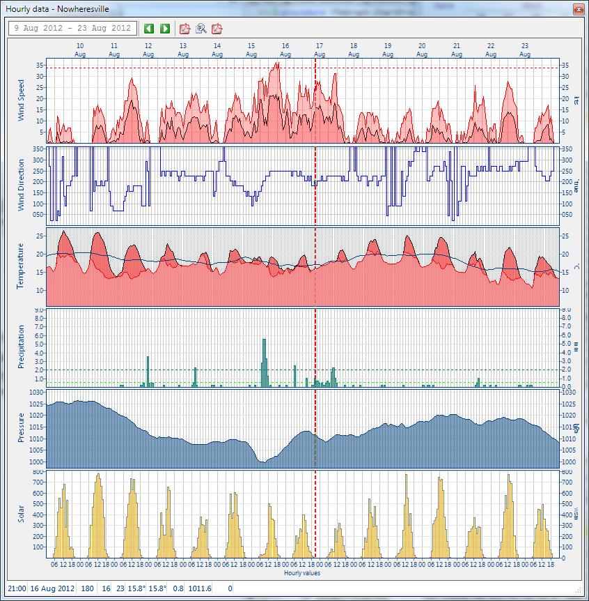

Thanks for the link - I had a try at some of these work arounds and none of them work very satisfactorily.
I tried keeping the labels and using the same colored font for the test as the background. This works OK put appears on printing. Tried your suggestion of taking over the label drawing and painting nothing to the screen - the grid disappeared. I found you need to add a single space to get the grid back. Tried setting the label on axis to false which does help but why I don't know.
I thought the grid spacing was controlled by the amount and size of the text that makes up the label but now I'm not so sure. What I would like is grid and label separating so you can turn labels off and leave grid on.
I can't get the 6 graph I have stacked on top of each other to scale the grid exactly the same despite having the increments top and bottom the same. I'll keep working at it but the whole area needs reworking in my opinion and is a complete minefield!
