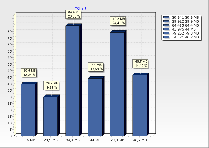

I fear this issue has been reintroduced in TeeChart Pro V2013 =(
When I create a test project including only the code of your first post in this Thread I get the following result:
I tested all types of AntiAliasText (gpfNormal, gpfDefault, gpfBest and gpfClearType)
It does not seem to make any difference. Seems like AntiAliasText is no longer regarded at all in V2013?!
Could you please assist?
Thanks and best regards

Re: Bar series - text alignment issue in marks label
Post by Yeray » Thu Jun 06, 2013 2:25 pm
I've incremented the ticket priority and added a couple of examples to reproduce the problem in the same ticket (TV52016337). So I hope this will work better in future releases.
The only workaround I can think right now is to modify the TextAlign:
Marks.TextAlign:=taLeftJustify;
