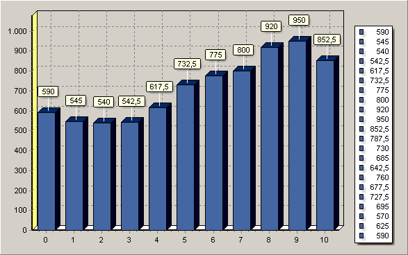

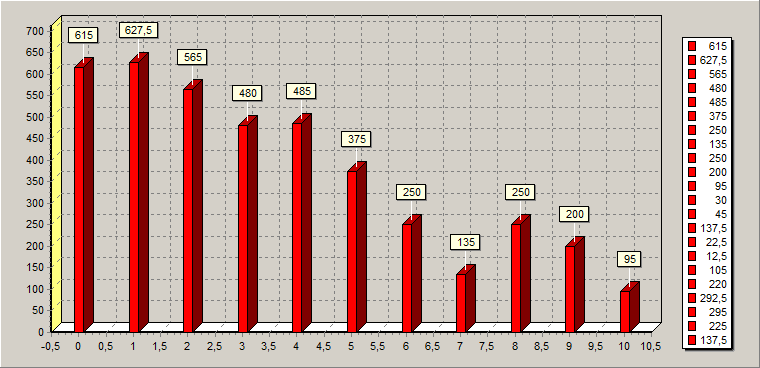

I consider an upgrade from Teechart VCL 8 to 2012 but am a little confused about the different "look" of one of my projects.
Here is how the chart looked like when compiled with 8.06 (Delphi 2007):
http://www.swiftease.de/images/Screensh ... rt8.06.png
and here with the 2012 Trial Version (same Delphi installation, no change in code):
http://www.swiftease.de/images/Screensh ... 012.07.png
The bars are much thinner. I played with the Series / % Bar width value already but with no effect.
How can I return to the old look with 2012?

... with your code I get thin bars with Ver. 2012 but thick bars with Vers. 8:
