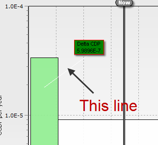

I can't figure out how to change the color of the lines from a graph that go to the text boxes when you move them.
I tried
seriesPt.ColorEachLine := True;
seriesPt.Pointer.Pen.Color := clRed;
seriesPt.Pointer.Color := clRed;
ptIdx := seriesPt.AddXY(xval, yval, 'test', clRed);
but the line still comes out white, what am I missing?

Do you mean the callout lines (the lines drawn from the points to the marks)?
Try this:
seriesPt.Marks.Callout.Pen.Color:=clRed;

I don't know what they are called, see attached image.
I tried the
but it did not work.
Here is code I use to get the attached image.
seriesPt.Marks.Callout.Pen.Color:=clRed; //I also put this at the end of the code below
ptIdx := seriesPt.AddXY(xval, yval);
seriesPt.Marks[ptIdx].Visible := showIt;
seriesPt.Marks[ptIdx].Color := clGreen;
seriesPt.Marks[ptIdx].Pen.Color := clRed;

Try this:
seriesPt.Marks.Callout.Arrow.Color:=clRed;

Thanks, that worked good.
