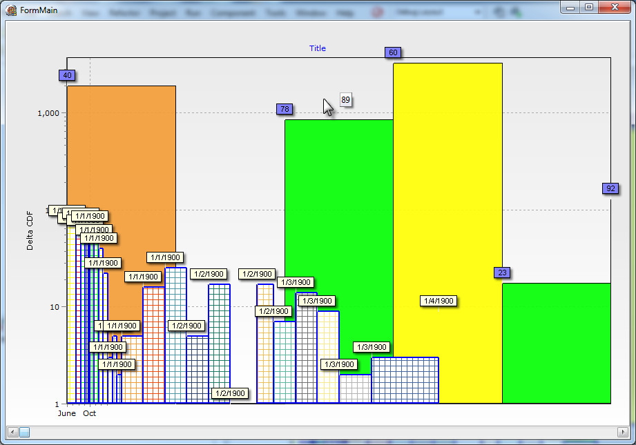

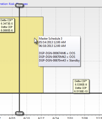

I currently have a TMarksTipTool and it pops up every time the mouse is anywhere on the chart (See popup 1).
However, it only updates (calls OnGetText) if the mouse is over actual data in the graph. (See popup 3).
Is there a way to make it so that the popup doesn't happen unless it is over a data item.
Or why does it not call OnGetText before it shows every time, instead of just when it is over new data?
- Updated when mouse is over the data
- popup3.png (19.19 KiB) Viewed 22133 times
- Tip not updated unless mouse move over item
- popup2.png (20.7 KiB) Viewed 22128 times
- Tips shown when not on graph data
- popup1.png (18.39 KiB) Viewed 22114 times

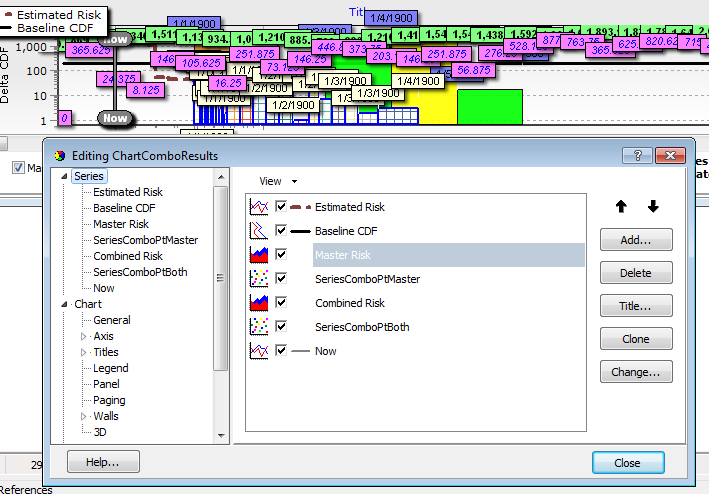

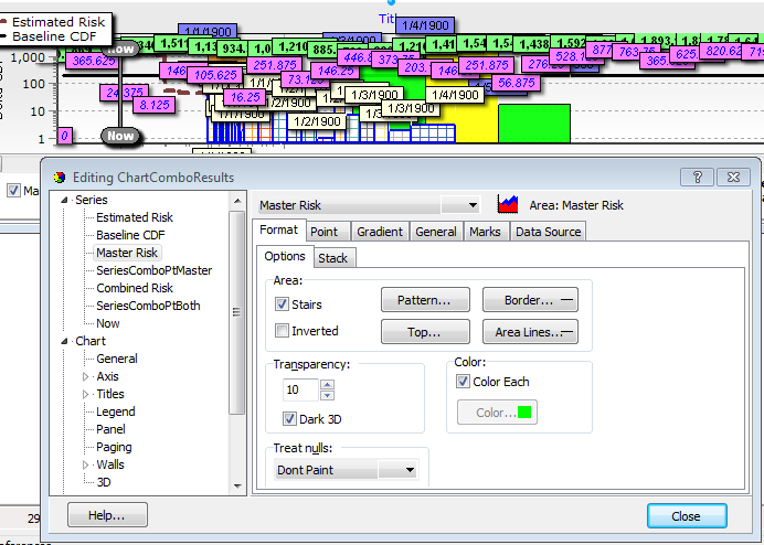

There are several things in the cart. The one producing the bars is an Area.
- chart2.png (51.38 KiB) Viewed 22084 times
- Chart1.png (53.77 KiB) Viewed 22101 times

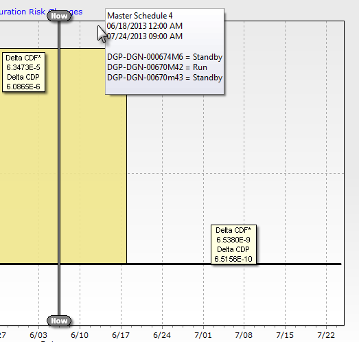

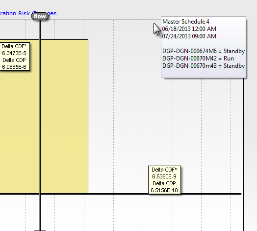

Still has issues for me.
(See pictures)
The # in the popup is the same.
It pops up when not on the bars.
I remembered we are a version behind because we had some conflicts with your latest version. Is this an issue that has already been fixed.
(See pictures)
- GraphPic2.png (54.28 KiB) Viewed 21945 times
- GraphPic1.png (54.2 KiB) Viewed 21950 times
