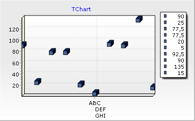

I've tried the following code:
uses Series;
  Chart1.MarginBottom:=12;
  Chart1.AddSeries(TPointSeries).FillSampleValues(10);
  Chart1.Axes.Bottom.SetMinMax(0,9);
  Chart1.Axes.Bottom.Items.Add(5, 'ABC' + TeeLineSeparator + 'DEF' + TeeLineSeparator + 'GHI');
This is how it looks with v2013.08:

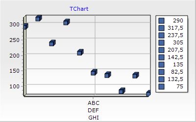

And this is how the same example looks with the actual sources (and with the beta) we have here:
So it should be fixed with the next maintenance release.
