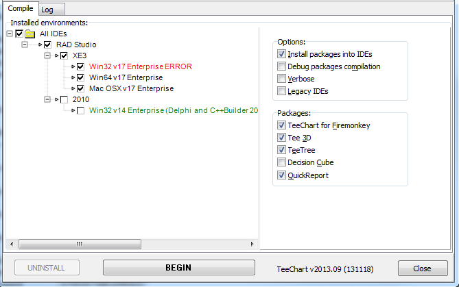

Teechart pro with source D2010 has been successfully installed in my conputer, but XE3 failed.
A partial copy of install log is here, please help.

Cannot install latest VCL version under XE3
- 1.png (26.03 KiB) Viewed 7785 times
