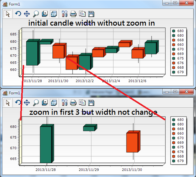

The result here is still not working, I wonder if this problem is platform dependent.
We are using D2010 here, so I have to remove all "VclTee." in source in order to compile this project .
I don't know whether or not the change I made can alter program behavior between yours and mine.
I'm using v2013.09.131118, does 2013.09.131119 contains TColorlineTool fix you send me last week?
Attached the running result from my PC FYI.

I think I didn't understand your problem correctly. After zooming I saw I could still resize the chart and the candles would also resize accordingly. However, I now understand that the problem is that candles don't resize when zooming. Is that correct? Actually, given your code, it won't work as you are using this formula:
  Series1.CandleWidth := (Chart1.Width - 250) div SAMPLE_COUNT;
For this to work when zooming you should either change it to take into account bottom axis range or the number of visible points in the chart. Remember that zooming changes both axis range and number of points visible.

We tried to achieve that using the attached project. However, it's still not working. CandleWidth only works when axis scales are automatic (no zoom). It's a bug ([ID489]) which we will try to fix.
