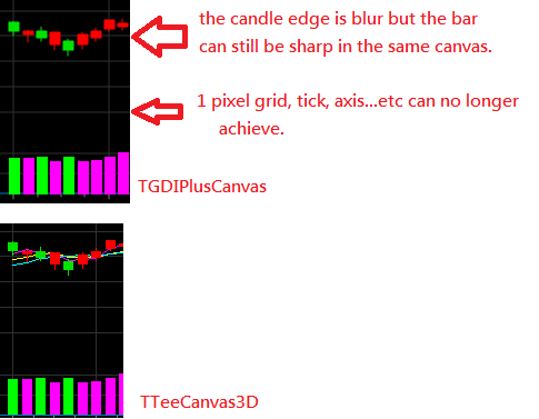

I'm trying to upgrade my project from TTeeCanvas3D to TGDIPlusCanvas for more eye candy.
Currently there are 2 noticeable differences that I'd like to ask for advice.
1. How can I have a sharp TCandleSeries in TGDIPlusCanvas? just like TBarSeries does. They are all about rectangle and straight line after all.
2. 1 pixel setting is not presenting any more. Can I have it back? they are all straight lines though.
sswang
Posts: 24
Joined: Wed Mar 28, 2012 12:00 am
Re: Some questions about TGDIPlusCanvas
Post by sswang » Fri Nov 29, 2013 7:07 am
The question 1 is more important because it actually makes visual comparison of OHLC prices more harder for our customers.

How can I make TCandleSeries to be as sharp as TBarSeries does while AntiAlias:=True?
