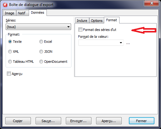

I've note 2 small glitchs in the french dialogs:
1) Checkbox size too small for translation
TeechartExportGlitch #2.png (33.07 KiB) Viewed 16198 times

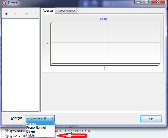

2) list box item not translated (in the filters dialog)
TeechartExportGlitch #1.png (46.6 KiB) Viewed 16202 times

Re: French Export
Post by Yeray » Mon Mar 31, 2014 3:00 pm
Hi
zyma wrote:1) Checkbox size too small for translation
Corrected for the next maintenance release. Thanks for reporting it.
zyma wrote:2) list box item not translated (in the filters dialog)
You can declare set the HIDDEN variable as follows:
uses EditChar, TeeTranslate, TeeFrench, TeeConst;
  EditChart(Self, Chart1);
  TeeSetFrench;
  TeeFrenchLanguage.Text:=TeeFrenchLanguage.Text+'HIDDEN=Caché'+NewLine;

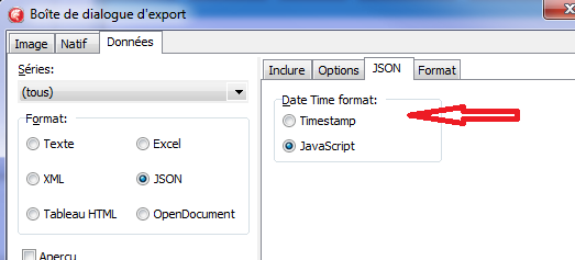

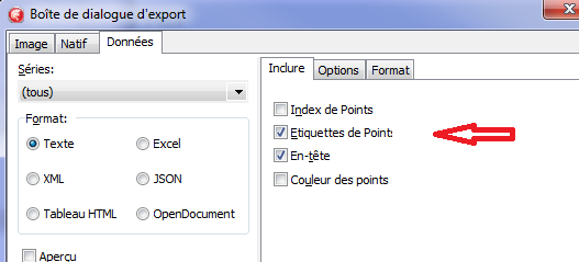

Post by zyma » Tue Apr 01, 2014 3:26 pm
Found 2 other small glitches (one is size, the other is captions not translated.)
I've started comparing the units... what is the best way to process, I'll translate and fix my code to fit my immediate needs (I really need to release the software) , but what's next... can we except a complete fix soon... ???
TeechartExportGlitch #4.png (23.67 KiB) Viewed 16172 times
TeechartExportGlitch #3.png (24.49 KiB) Viewed 16170 times

Re: French Export
Post by Yeray » Wed Apr 02, 2014 8:09 am
I've set this label wider to fit it with the next maintenance release.
Add this to TeeFrench.pas:
'HIDDEN=Caché'+NewLine+
