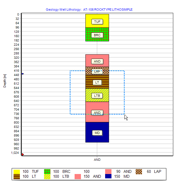

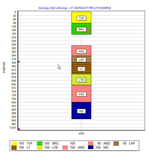

X-Axis and Vertical Zoom Problems. I have created a stacked bar chart, setting self.owner.chart.BottomAxis.Automatic := True. I have the following problems:
1. The x-axis always displays the fourth rock type code, which I am unable to hide. Why is this and how do I hide this label? See attachment Label_On_XAxis.
2. The graph is always displayed in the centre of the x-axis. Is it possible to specify where the bar chart is located?

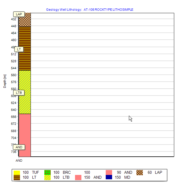

3. When I zoom, the chart always jumps to the left axis. Why is this and how do I prevent this? See attachments Zoom and After_Zoom.
4. Can I make the legend symbols higher without increasing the font. If I set self.Owner.Chart.Legend.Symbol.Continuous := True; the legend symbol height is increased for all but the first and last. Is it possible to increase the height for all symbols.

Errol wrote:1. The x-axis always displays the fourth rock type code, which I am unable to hide. Why is this and how do I hide this label? See attachment Label_On_XAxis.
Doing the following, I get "label 0" in the bottom axis label.
uses Series;
var i: Integer;
  Chart1.View3D:=false;
  Chart1.Legend.Alignment:=laBottom;
  for i:=0 to 4 do
      Add(50+random*25, 'label ' + IntToStr(i));
      MultiBar:=mbStacked;
      MarksOnBar:=true;
      MarksLocation:=mlCenter;
If you are doing something similar to the above, and you want to show no text in the bottom axis, you can use the OnGetAxisLabel as follows:
uses Series;
var i: Integer;
  for i:=0 to 4 do
      MarksOnBar:=true;
  Chart1.OnGetAxisLabel:=GetAxisLabel;
procedure TForm1.GetAxisLabel(Sender:TChartAxis; Series:TChartSeries; ValueIndex:Integer; var LabelText:String);
  if Sender=Chart1.Axes.Bottom then
    LabelText:='';
Errol wrote:2. The graph is always displayed in the centre of the x-axis. Is it possible to specify where the bar chart is located?
Yes, playing with the bottom axis minimum and maximum properties. In the example above, we've added the values with the Add() method, specifying no XValue. Doing it this way, the XValue is generated by TeeChart and it is 0. Then, if you want to move the bar to the left, you can set a bottom axis minimum -1 and a maximum 2. Ie:
Chart1.Axes.Bottom.SetMinMax(-1, 2);
Errol wrote:3. When I zoom, the chart always jumps to the left axis. Why is this and how do I prevent this? See attachments Zoom and After_Zoom.
It won't happen any more if you implement the solution for the point above (2).

I have successfully removed the X-Axis labels and placed the bar chart where required, as your suggestion to use SetMinMax - thanks. I had previously tried using Chart1.BottomAxis.Minimum and Chart1.BottomAxis.Maximum to set the axis range. The chart still moves around a bit on Zoom, so I wrote an OnZoom event to reset the X-axis Min and Max values each time.
