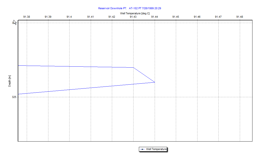

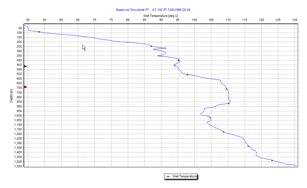

I have just noticed that the increments on my chart axes are now not showing sensible values. Formerly, I could set an axis increment to say 0.01, and the axis labels would automatically adjust to 55,60,65 etc when the axis range was large, and 91.41, 91.42 etc when I zoom in. See attachments. This was a very nice feature.

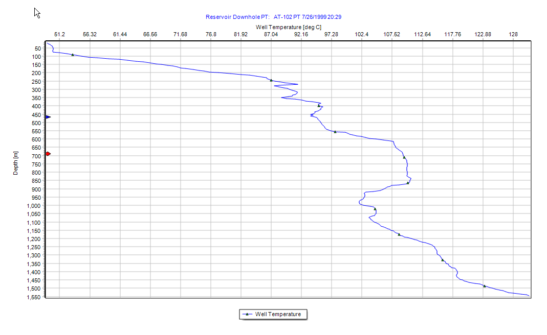

Now, if I set the increment to 0.01, I get decimals shown at every axis label. This is very unsatisfactory. I have relatively recently installed TeeChart 9 but I do not know if this is the cause of the problem. As far as I can see, there does not seem to be any code controlling the axis labels. How can I return the behaviour to how it was before?

I see TeeChart v2013.08 draws different labels than the actual version when the increment is really smaller than the axis range.
I'll open a ticket to further investigate it.
http://bugs.teechart.net/show_bug.cgi?id=698
In the meanwhile, you can always set an increment or another one depending on the axis range.
