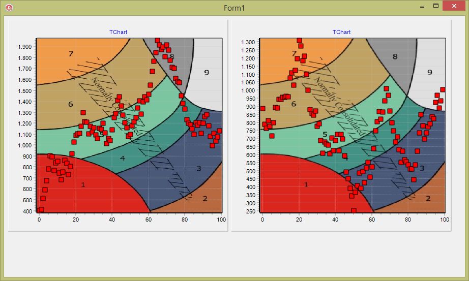

I am using the latest 2014 32 bit VCL with Delphi XE (Windows 7 64 bit) and I noticed that with GDI+ when a back image is defined, the chart slowly redraws (e.g. pan and zoom are slow). If I use the GDI canvas then performance is ok. Does anyone noticed this behavior? Is there a work around? I did try setting back image draw quality to low but this does not help.

Ok, here is what I found by mistake :) After adding a filter to the back image performance looks normal. Attached is a sample project (also notice that the unfiltered image is not displayed correctly)

I could reproduce both problems here using the latest binary version but they are solves with our current sources:
I can send you a test version so that you can test if it solves the problem at your end.

I can confirm that the test version solves the issue!!! Thank you very much for your prompt reply and support :)
