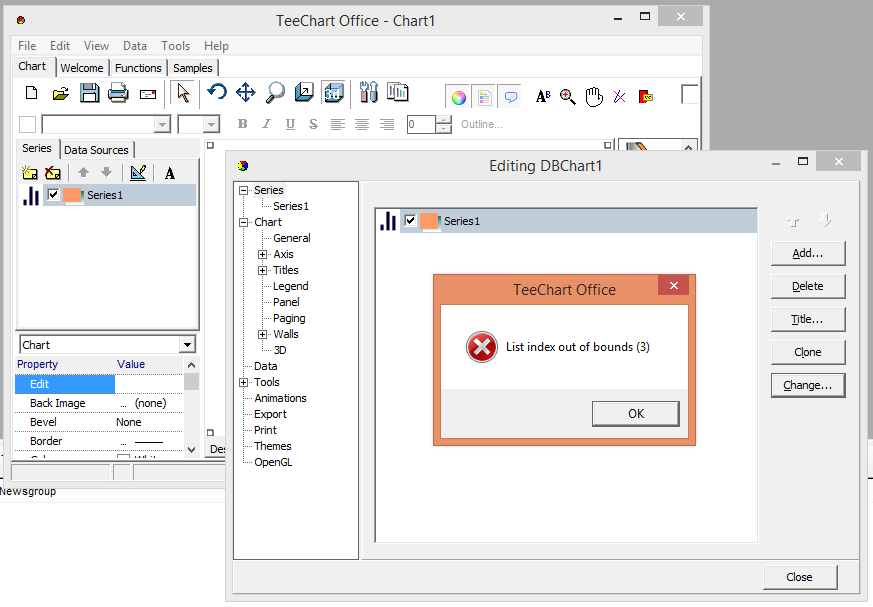

Using the May 12 release I get this error everything time I try to change the series type.
5-23-2014 9-02-18 AM.png (43.67 KiB) Viewed 10135 times

I've been able to reproduce the problem so I've added it to the public tracker:
http://bugs.teechart.net/show_bug.cgi?id=781

I've added this on 29 April as "Change series error in the Chart Editor ", but up to now this is not fixed yet.
This error exists in the previous release also.

anauta2014 wrote:I've added this on 29 April as "Change series error in the Chart Editor ", but up to now this is not fixed yet.
You are right. This was identified here.
I've marked B781 as a duplicate of B753.
