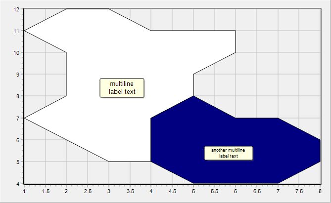

I've tried to reproduce this with the code below:
But this is what I'm getting, that looks correct to me:
Could you please try to modify the code above so we can reproduce the problem here?
Alternatively, could you please arrange a simple example project with the same purpose?

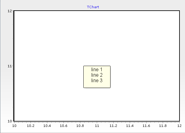

Basic example as follows :-
TMapSeries* map = new TMapSeries(Chart1);
map->Marks->Visible = true;
Chart1->AddSeries(map);
Chart1->Legend->Visible = false;
TTeePolygon* shape = map->Shapes->Add();
shape->Text = "line 1\rline 2\rline 3";
shape->Closed = true;
shape->Points->AddXY(10, 10);
shape->Points->AddXY(10, 12);
shape->Points->AddXY(12, 12);
shape->Points->AddXY(12, 10);
Results in the following image which you can see the top of the text border is at the half way mark. With the older versions of TChart the text would be centred at Line 2 with Line 1 above the centre and Line 3 below the centre of the box.

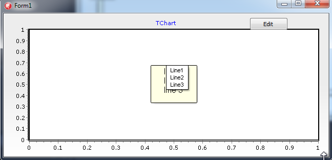

Hey Yeray,
Yes was the code I tested with initially on 2015.15.150420 and our production release with last 2014.X
Its not perfect but pretty close to centered, image attached from 2015.X
Larger text is with the vertical adjustment in the DrawMark() function, the smaller test was just my quick test with TAnnotationTool
