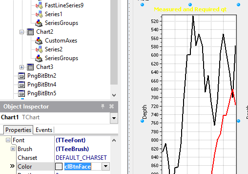

If you drop a Chart into a form and change the title font color to clBtnFace it drawn as yellow (latest TeeChart, Delphi XE6).

If you look at the screenshot you see that I need set the color of the title to match the color of the background, since the background color is clBtnFace how can I assign this to the title?

Attached is a project file, the clWhite button works fine but the clBtnFace button turns the font color to yellow.
