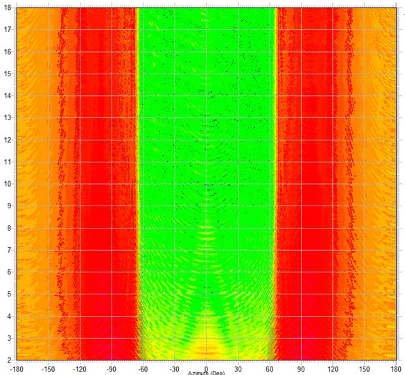

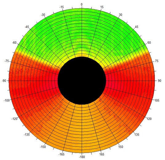

I am trying to create a chart that is sort of a cross between a polar plot and a color grid. Is this possible?
It would look like this...
It was created from a TColorGridSeries that Looks like this...

I am looking at it now. Is there a way to leave the center empty/transparent (as shown above), or even display a BMP in it? I do not want the inside pixels so close together. Thanks.
