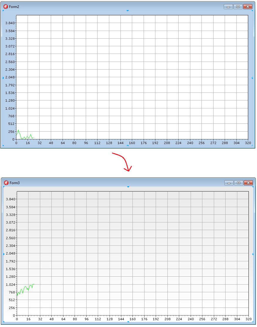

Copying a TChart from one Form to another does not work correct.
At least Chart->Panel->Gradient will be set to 'visible' in the copy even though it wasn't in the original grid.
This also holds true for Chart->Walls->Back->Gradient 'visible'
But I think this bug will appear for all gradients.

Ok, maybe I wasn't clear enough but I ment copying a TChart from one Form to another Form inside the IDE.
Here is a preview how it look likes: The attached code was used to produce both images and you can try it for your self. It has the original TChart on TForm2 in unit Unit2.pas. TForm3 in Unit3.pas is empty so open both forms, navigate to TForm2 select the TChart and copy it to the clipboard (Ctrl+C). Then activate Unit3.pas and insert the TChart (Ctrl+V).

Thanks for your project and your clarification. We've added the problem in VCL TeeChart bugzilla tracker to fix it to upcoming versions of TeeChartVCL with number ID866.
Meantime, a simple workaround is going to the Chart Editor->Panel->Gradient and disable the visible check box.
