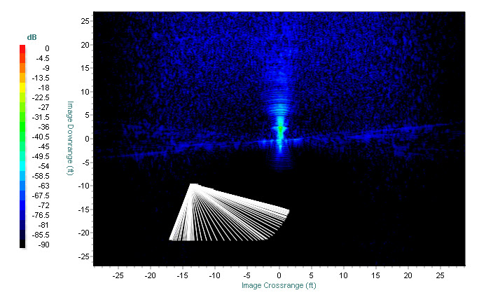

Thanks for your response. I am a source code client using TeeChart Pro v2013 32 bit. My application is now exactly like the code you have in this post. When I move the mouse, the old lines still are not removed. I have attached a screen shot showing my issue. This image was drawn on a TColorGridSeries. As you can see in the image, the white lines at the bottom were created after a mouse down and mouse move events.

Many thanks for your information. The problem you are experiencing doesn't occur for me using latest TeeChart Pro VCL/FMX source code and the code I have attached for you in my last post.
Could you please download the TeeChart Pro Source code 2014 and check again if the problem, you are experiencing, still appears? You can get the latest TeeChart Pro VCL/FMX source code from our customer download page.

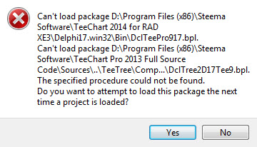

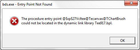

Thanks again for you response. I downloaded the latest version and installed it. When I open the project I get the following errors. I first get this one:
First Load Error.jpg (29 KiB) Viewed 30875 times
I then get this one:
Second Load Error.jpg (49.07 KiB) Viewed 30876 times
Any thoughts? I think I have all the paths correct, but I must not. Can you advise me on how to fix this? Thanks in advance.

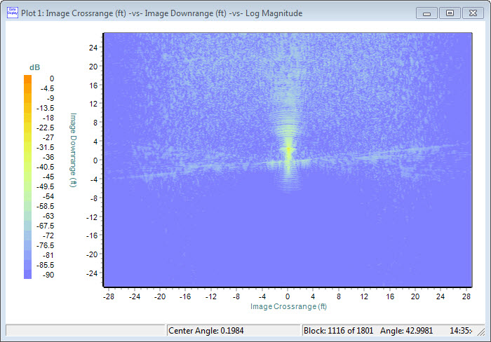

OK, I have worked through all the issues except the color palette. Before installing the latest update, my image was drawn as shown above. Now, without code change, the image color is drawn as shown here:
Image Color.jpg (107.75 KiB) Viewed 30870 times
What do you think changed? I call ClearPalette and AddPalette the same as I always have. It seems that where the palette is getting initialized internally has changed, meaning it is being initialized after I set it. If I set it again after displaying the incorrect image, it modifies the palette and displays the image as I expect. Any insight would be helpful.

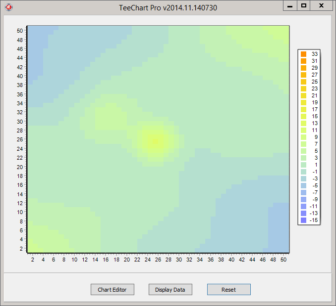

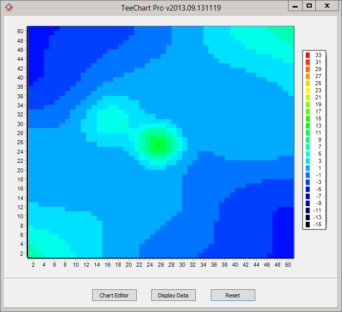

I've tried your testing application with all the versions from v2012.07 to the actual v2014.11 and found the palette seems to change from v2014.10. And switching to GDI doesn't change it.
Here is how it looks in v2013.09:
And this is how it looks in v2014.10 and v2014.11:

dpatch wrote:every once in a while I make a change in the chart editor that causes the color on either the plot or the legend to change and be correct. But, it is not repeatable. Once it changed the plot when I switched between GDI and GDI+. another time it changed the legend when I made it not visible, then visible again.
In the tests I've made up to now, I haven't found a setting in the editor that makes the colorgrid to look as before.
