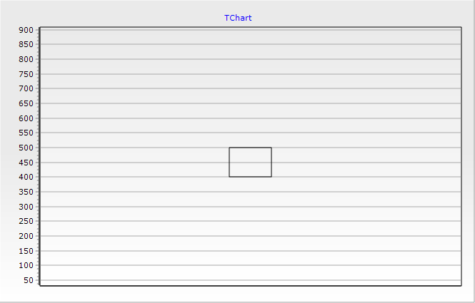

Here the complete code of an example I just made to check it:
uses Series, TeCanvas;
  Chart1.View3D:=false;
  Chart1.AddSeries(TFastLineSeries);
  Chart1.Axes.Left.SetMinMax(33,909);
  Chart1.Axes.Bottom.SetMinMax(0,100);
  Chart1.Axes.Bottom.Labels:=false;
var tmpLeft, tmpRight, tmpTop, tmpBottom: Integer;
  tmpLeft:=Chart1.Axes.Bottom.CalcPosValue(45);
  tmpRight:=Chart1.Axes.Bottom.CalcPosValue(55);
  tmpTop:=Chart1.Axes.Left.CalcPosValue(400);
  tmpBottom:=Chart1.Axes.Left.CalcPosValue(500);
  Chart1.Canvas.Brush.Style:=bsClear;
  Chart1.Canvas.Rectangle(tmpLeft, tmpTop, tmpRight, tmpBottom);
I'm drawing a rectangle with OnAfterDraw event to check the bottom axis has the correct minimum and maximum values. Because once you hide the labels, you loose that reference.

Post by Chartist » Thu Sep 04, 2014 5:56 pm
thank you so much for this genius and complete solution!
