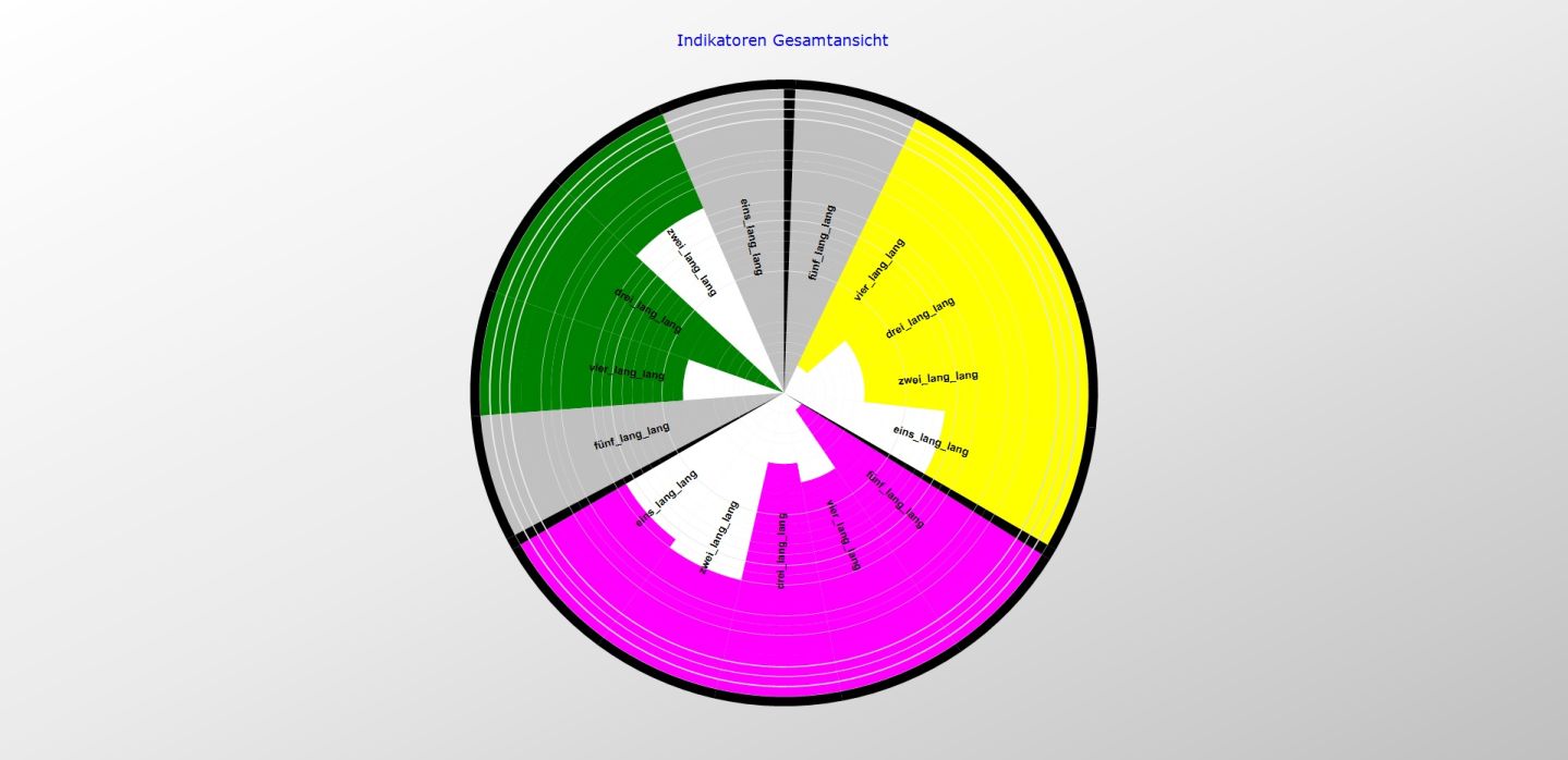

I try to export a TeeChart to a pdf-file. The chart is from the template gallerie, the Concentric Donuts. After export, the chart is screwed-up. At the pdf-file, there are only the marks from the chart but no chart. Please can you help me?

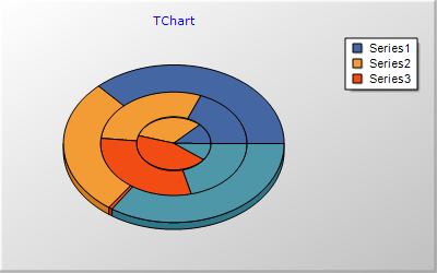

Hi Peter,
The concentric Donuts Template doesn't look as the one you posted above for me here.
Here it is how it looks for me:
And here it is the pdf I get with this code:
As an alternative, you could print the chart with a virtual pdf printer:

you are right, it looks a bit different but I use the concentric Donuts Template. I like to show the values as 100-perscent-columns, the middle of the circle is 100%. So I use the concentric Donuts and give all values the same width. Then I set the color of the values from outer (0%) to inner (100%) of the circle. What chart-type can I use as alternative to my solution? The new Rose Series show the values from inner circle to outer circle and use polar coordinates, but I need free scaling for the circle, not 360°.
Have you an idea what chart type better fit my needs?

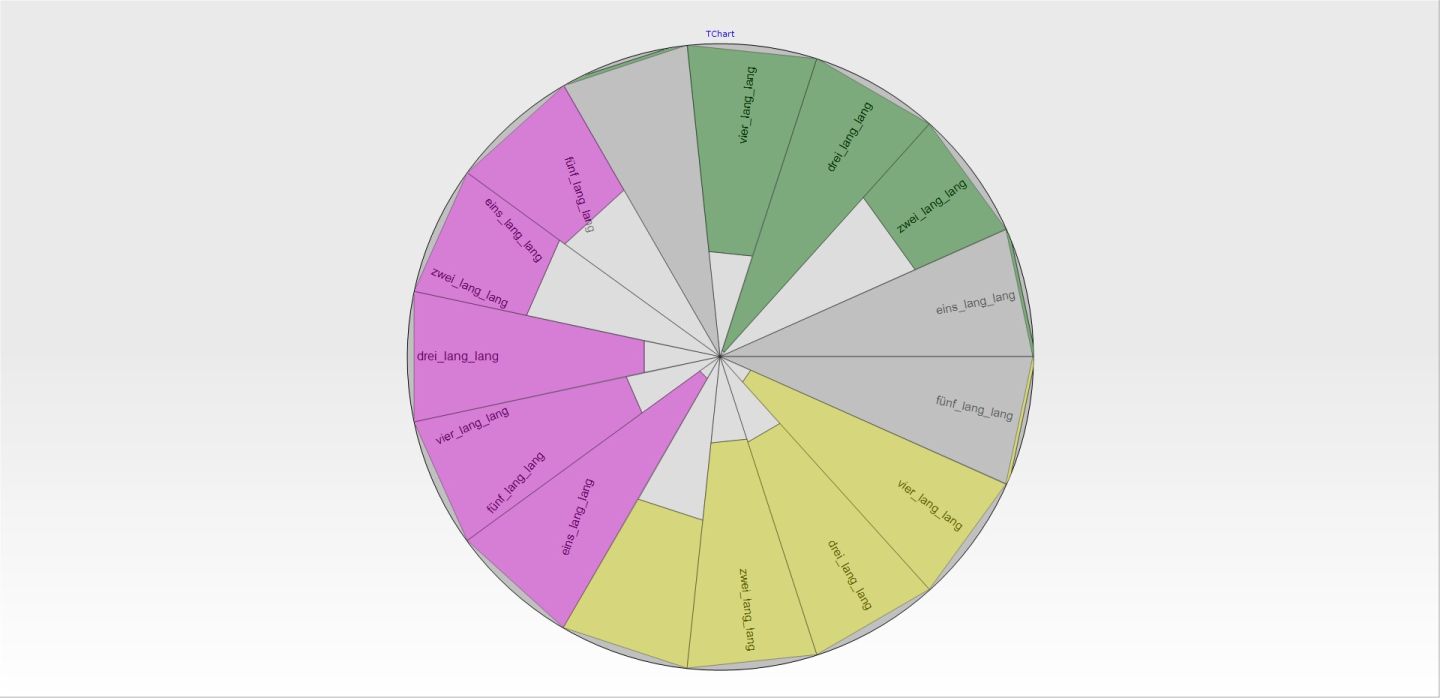

Re: PDF export screwed-up chart
Hello Peter,
I've been trying to do a demo using the Rose series. I found some issues but I one problem I can't find how to workaround: some circle labels seem not to be drawn depending on the number of values.
On the other hand, we'd be pleased to investigate the problem exporting the concentric pies, but we'd need a simple example project we can run as-is to reproduce the problem here.

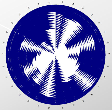

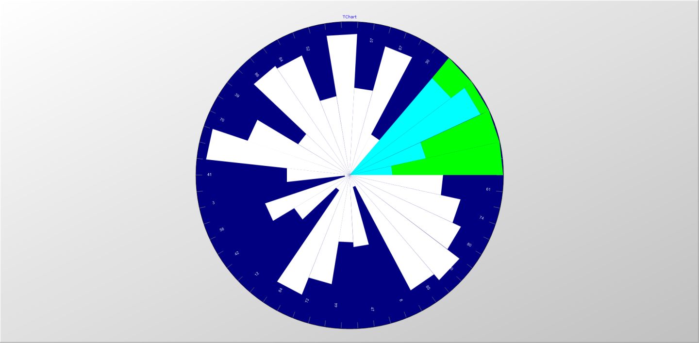

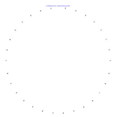

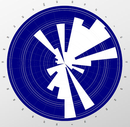

Hi Peter,
However, it seems to work fine if I print the chart using a virtual pdf printer, instead of exporting the chart to a pdf.
Exporting to a pdf file works better than with the TPieSeries, but not perfect: the labels in the main chart disappear. However, printing the chart with a virtual pdf printer also works fine:
I could reproduce the problem with your project when exporting the chart to a pdf.peterlepan wrote:here is al little sample projekt about my problem.
By the way, an other problem is the positioning of the marks. I set the Marks on the most outer series, but the width of the serie is so big, that some other series are covered. I use curious parameters for the marks-arrow as workaround. Is there an other way in my case to fix the width of the outer serie independently from the marks?
I've corrected the example above and this seems to work better.Yeray wrote:I've been trying to do a demo using the Rose series. I found some issues but I one problem I can't find how to workaround: some circle labels seem not to be drawn depending on the number of values.
uses TeePDFCanvas;
Chart1.View3D:=false;
Chart1.Legend.Visible:=false;
with Chart1.AddSeries(TRoseSeries) as TRoseSeries do
Pointer.Visible:=false;
Pen.Visible:=false;
Color:=clWhite;
CircleBackColor:=RGB(0,0,128);
GetHorizAxis.Grid.Visible:=false;
GetVertAxis.Grid.Visible:=false;
GetHorizAxis.MinorTicks.Visible:=false;
CircleLabelsRotated:=true;
LabelsMargin:=10;
OnGetCircleLabel:=roseGetCircleLabels;
Chart1.Axes.Visible:=false;
TrackBar1.Max:=200;
TrackBar1.Min:=10;
TrackBar1.Position:=29;
TrackBar1.Frequency:=10;
procedure TForm1.recalcAngles;
var i: Integer;
with Chart1[0] as TRoseSeries do
for i:=0 to Count-1 do
AngleValue[i]:=i*360/Count;
AngleIncrement:=(AngleValue[1]-AngleValue[0]) / 2;
procedure TForm1.roseGetCircleLabels(Sender:TCustomPolarSeries; const Angle:Double; Index:Integer;
var Text:String);
var i: Integer;
Text:='';
if Round(Angle-AngleIncrement)=Round(AngleValue[i]) then
Text:=Labels[i];
procedure TForm1.TrackBar1Change(Sender: TObject);
var i, tmpValue: Integer;
Clear;
for i:=0 to TrackBar1.Position-1 do
tmpValue:=Round(random*100);
AddPolar(tmpValue, tmpValue, IntToStr(tmpValue));
recalcAngles;
Label1.Caption:='Num Values: ' + IntToStr(TrackBar1.Position);
end;Best Regards,
your sample works fine, but I have one problem. I need to show the values from outer to inner. The outer of the circle is 0% and the center of the circle stands for 100%. If I show the difference to 100% with the rose-serie, I see no chance to change the color for a single value from outer to inner. These color is set with the CircleBackColor.
Oh, I have an idea! I use a second rose-serie to set the color of my single values!
Thank your for your inspiration!
Best regards
Peter
Best regards
Peter
