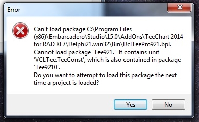

Hi, i'm trying to install TeeChart Pro v2014 Build 2014.12.140923 on DelphiXE7
when i start Delphi i got this error ( see image )
please help us, thanks
Andrea
Re: Install problem on Delphi XE7 and TeeChart Pro v2014 Build 2
Post by Yeray » Fri Nov 14, 2014 12:13 pm
Hi Andrea,
The error message "Cannot load package Tee9XX. It contains unit *, which is also contained in package Tee9XX0" indicates that the TeeChart package that was shipped with the IDE (Tee9XX0) is still trying to be loaded, and this creates a conflict with the version you've just installed.
Note XX above refers to the IDE number. For XE7 it's 21, XE6 is 20, XE5 is 19, XE4 is 18,...
In your case, please, unselect the TeeChart Standard package shipped with the IDE (Tee9210), and you should be able to safely select the TeeChart Pro/Std commercial package (Tee921).
If you continue to find the same error in a new simple application with just a chart on the form, then note any 3rd party tool you may have installed (*) can also be referencing TeeChart Standard package shipped with the IDE, and thus causing a conflict. Please try to unselect temporally any 3rd party tool package you may have installed in the list of packages.
(*) Some known 3rd party tools using TeeChart Standard are: FastReports, DevExpress and ReportBuilder.
