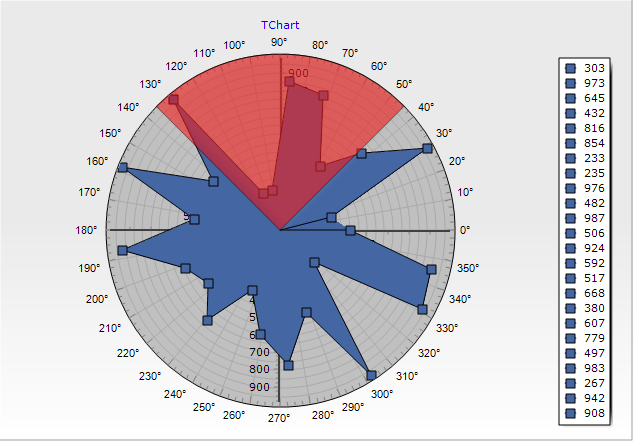

I tried your idea of using a TPieSeries and it seems to work wonderfully for me here:
  Chart1.View3D:=false;
  with Chart1.AddSeries(TPolarSeries) as TPolarSeries do
    FillSampleValues;
  with Chart1.AddSeries(TPieSeries) as TPieSeries do
    ShowInLegend:=false;
    Marks.Visible:=false;
    Transparency:=50;
    AddPie(10, '', clRed);
    RotationAngle:=45;
    AngleSize:=90;
Maybe you are doing something else that makes the TPieSeries not to fit correctly.
If you still find problems with it, please try to arrange a simple example project we can run as-is to reproduce the situation here.
An alternative would be using custom drawing techniques.

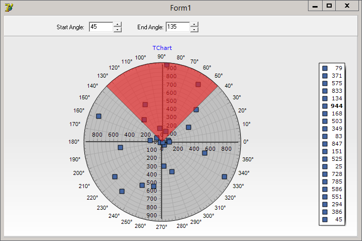

I've improved the example above a little bit:
testPolarBand.zip
(1.97 KiB) Downloaded 1543 times
But as you say it could still be interesting if TColorBandTool would support TPolarSeries so I've added it to the public tracker:
http://bugs.teechart.net/show_bug.cgi?id=1014

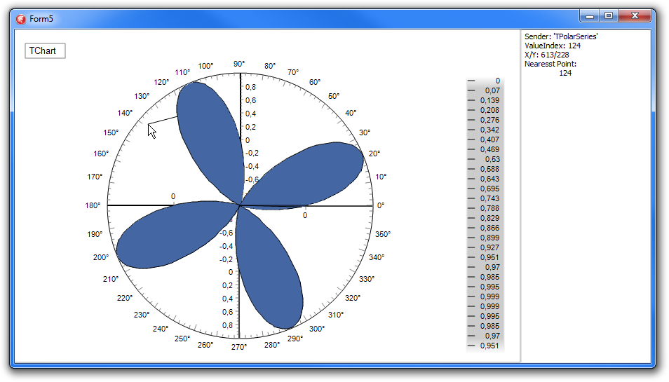

I still haven't entirely given up on this idea. Is there any way to determine where the user clicks/taps? I know about GetCursorValues(..) and GetCursorValueIndex() method of TChartSeries but they seem to fail on a TPolarSeries and descendants. GetCursorValues outputs weird stuff whereas GetCursorValueIndex always returns -1 ("no point close to the mouse cursor position").
Any idea?

The series OnClick event already gives you the index of the point the user has clicked. Ie:
var polarSeries: TPolarSeries;
    pieSeries: TPieSeries;
  polarSeries:=Chart1.AddSeries(TPolarSeries) as TPolarSeries;
  with polarSeries do
    FillSampleValues;
    Brush.Style:=bsClear;
    Pen.Visible:=false;
  polarSeries.OnClick:=PolarSeriesOnClick;
procedure TForm1.PolarSeriesOnClick(Sender: TChartSeries; ValueIndex: Integer;
            Button: TMouseButton; Shift: TShiftState; X, Y: Integer);
  Caption:=IntToStr(ValueIndex);
jens.mertelmeyer
Posts: 31
Joined: Fri Nov 21, 2014 12:00 am
Re: Selecting an area of a TPolarSeries?
Post by jens.mertelmeyer » Fri Dec 19, 2014 11:04 am
Thank you for the suggestion. However, that only works when clicking some point exactly. Which almost impossible when used on a touch screen and/or there are many values (360 or 720).
So far, the closest match I was able to get was by using a TNearestTool which operates on points, not on the axis.
This is still pretty inaccurate but probably better than nothing at all :roll:
