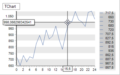

Exactly. I did it like this:Yeray wrote:since the same result can already be done without much effort
procedure TForm8.cursorToolChange(
Sender: TCursorTool;
x, y: Integer;
const XValue, YValue: Double;
Series: TChartSeries;
ValueIndex: Integer);
annotationTool.Top := Y - (annotationTool.Height div 2);
annotationTool.Text := YValue.ToString();
end;- Attachments
- cursorTool and annotationTool.png (13.24 KiB) Viewed 12544 times
