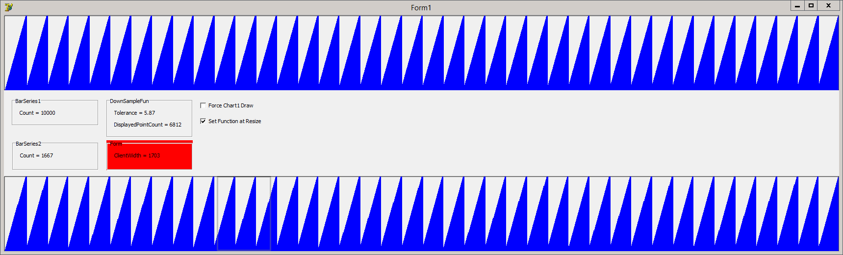

This works 90% of the time, but there are situations where the downsampled chart has less points than visible pixels (on the x-axis), which looks like this:
instead of:
If you resize the form from narrow to wide, the effect can be seen. In my real application the problem is even more visible.
How would I have to modify the application so the vertical 'white' lines will never be visible?

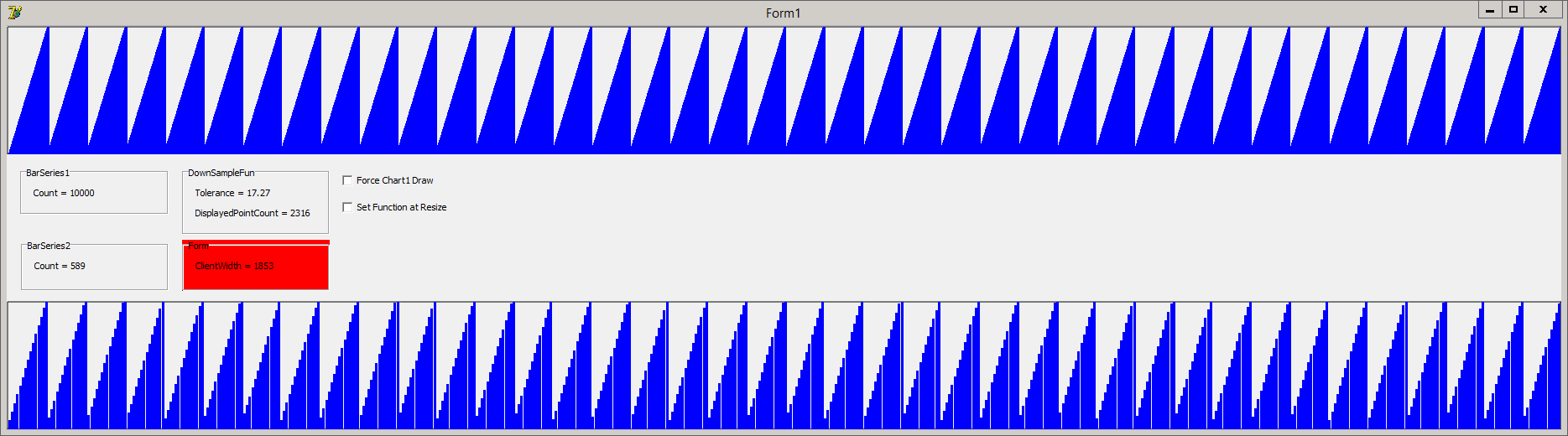

When resizing the form there are still lots of situations where there are more pixels visible on the screen than samples in the chart:
  if ClientWidth > BarSeries2.Count then
    GroupBoxForm.Color := clRed
    GroupBoxForm.Color := clBtnFace;
(The GroupBox will color red)
This isn't always visible in the sample application because the barwidth is more than 1 pixel. In my application the barwidth is 1 pixels.

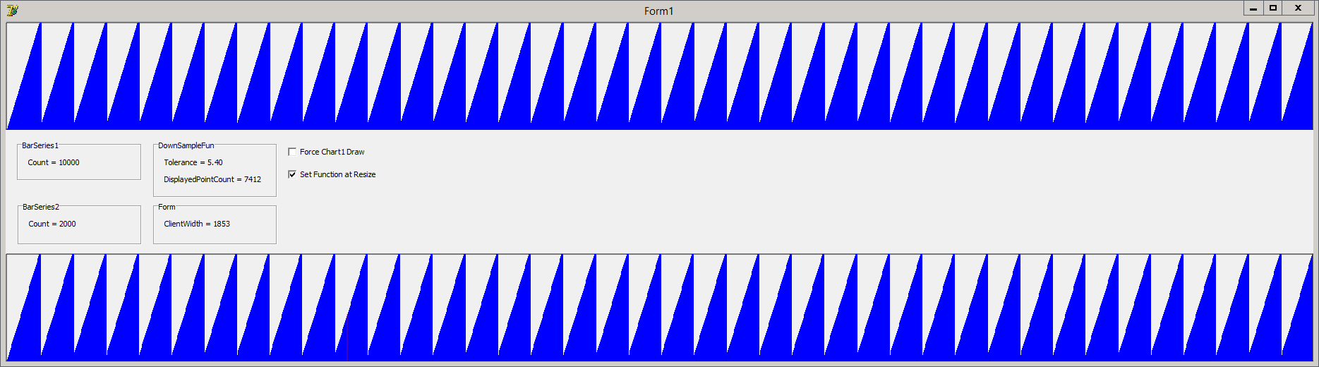

I could see the problem now consistently resizing the application I sent you to more than 1800 pixels width:
I've seen it can be fixed if you recalculate and reset the function Tolerance and DisplayedPointCount properties according to the current width (activating the new checkbox in the revision of the test application):
Now, I can see the box is still red for some widths, but the series always seems to look good:
TeeChart_DownSampling_rev2.zip
(2.45 KiB) Downloaded 467 times

When resizing the form BarSeries2.Count jumps from 589 to 625, etc. Take a look at the table below:
  BarSeries2.Count  ClientWidth  Status
  589               579 - 589    OK
                    590 - 606    not OK
  625               607 - 625    OK
                    626 - 645    not OK
  667               646 - 667    OK
                    668 - 689    not OK
  715               690 - 715    OK
                    716 - 740    not OK
  770               741 - 770    OK
                    771 - 799    not OK
  834               800 - 834    OK
                    835 - 869    not OK
  910               870 - 910    OK
                    911 - 952    not OK
As you can see the function to downsample only works for roughly 50% of the time.
Bert
Bert B.
Posts: 8
Joined: Wed Mar 02, 2011 12:00 am
Re: TDownSamplingFunction question
Post by Bert B. » Wed Dec 17, 2014 9:52 am
After further studying the table above I discovered the following:
  589 = 10000 / 17
  625 = 10000 / 16
  667 = 10000 / 15
  715 = 10000 / 14
  770 = 10000 / 13
  834 = 10000 / 12
  910 = 10000 / 11
So it only makes sense to specify integer values for the tolerance.
Changing the procedure SetFunctions as follows makes it work:
procedure TForm1.SetFunction;
var
  NewTolerance : Integer;
  NewTolerance := Round(BarSeries1.Count / ClientWidth);
  if (BarSeries1.Count div NewTolerance) < ClientWidth then
    Dec(NewTolerance);
  DownSampleFun.Tolerance := NewTolerance;
  DownSampleFun.DisplayedPointCount := (BarSeries1.Count div NewTolerance) * 4;
This should do for now, but a real fix is appreciated.
