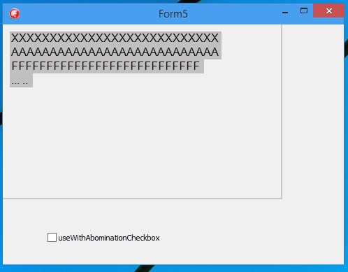

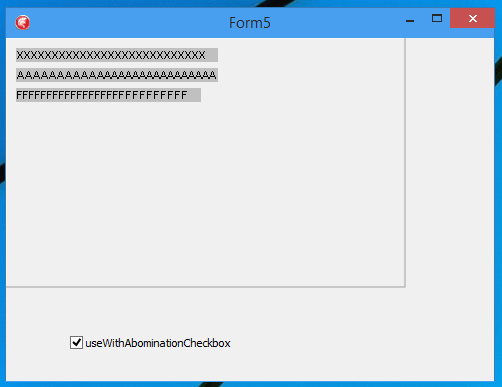

I have a feeling that this is going to be another prime example of why the with-statement in Pascal is a terrible abomination.
I refactored your code a bit. Please have a look at the produced output.
The code:
procedure printText(
	const	onCanvas:	TTeeCanvas;
	const   atPosition:	TPoint;
	const	text: 		String
var
	backgroundRect: TRect;
	Assert( Assigned(onCanvas) );
	onCanvas.Brush.Color := clSilver;
	backgroundRect := TRect.Create(
		atPosition.X,
		atPosition.Y,
		atPosition.X + onCanvas.TextWidth(text),
		atPosition.Y + onCanvas.TextHeight(text)
	onCanvas.FillRect(backgroundRect);
	onCanvas.TextOut(atPosition.X, atPosition.Y, text);

Hi Jens,
Changing this:
      with Draw3D1.Canvas do begin
         Font.Height:=-11;
For this:
         Font.Size:=fontSize;
Seems to make your example code to draw the same when the checkbox is checked and when it's unchecked.

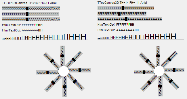

I am a little confused. I have checked the same code with the old GDI Canvas and the buggy result is as follow:
Here the code:
const
  fHeight=-11;
procedure TForm1.Draw3D1Paint(Sender: TObject; const ARect: TRect);
var
  s:String;
  x,y:Integer;
  x:=10; y:=10;
     Font.Height:=fHeight;
     TextOut(x,y,ClassName); y:=y+20;
     s:='XXXXXXXXXXXXXXXXXXXXXXXXXXX';
     Brush.Color:=clSilver;
     FillRect(Rect(x,y,x+TextWidth(s),y+TextHeight(s)));
     TextOut(x,y,s); y:=y+20;
     s:='FFFFFFFFFFFFFFFFFFFFFFFFFFF';
     s:='AAAAAAAAAAAAAAAAAAAAAAAAAAAA';
     TextOut(x,y,'FFFFFFFFFFFFFFFFFFFFFFFFFFF<b>HH</b> ',True); y:=y+20;
     TextOut(x,y,'AAAAAAAAAAAAAAAAAAAAAAAAAAA<b>HH</b> ',True);
procedure TForm1.cbGDIPlusClick(Sender: TObject);
  if cbGDIPlus.Checked then begin
    Draw3D1.Canvas:=TGDIPlusCanvas.Create;
  end else begin
    Draw3D1.Canvas:=TTeeCanvas3D.Create;
    TCanvasAccess(Draw3D1.Canvas).FontQuality:=fqDefault;
In the source code I can find in VCLTee.TeeGDIPlus the lines:
  FGraphics.MeasureString(St,Length(St),FGPFont,TeeZeroPoint, {TGPStringFormat.GenericTypographic,} tmpBox);
If I remove the comments to use Typographic, the result is better, but not good:
I cannot found your function "InternalTextWidth" in my source code. Is there a new source code version greater v2014.12.140923 ??
Jens

Truly, the GDI+ text function are very strange. But the result with the new code is not bad and you can also use the HTML-Out functions with GDI+:
var
  s:String;
  x,y,h,xp,yp:Integer;
  w:Single;
  x:=10; y:=10;
     Brush.Clear;
     h:=TextHeight('-');
     TextOut(x,y,Format('%s TH=%d FH=%d %s',[ClassName,h,Font.Height,Font.Name]));
     h:=h+5;
     y:=y+h;
     s:='XXXXXXXXXXXX█XXXXXXXXXXXXXXX';
     TextOut(x,y,s); y:=y+h;
     s:='FFFFFFFFFFFF█FFFFFFFFFFFFFFF';
     s:='AAAAAAAAAAAA█AAAAAAAAAAAAAAA';
     Font.Style:=[];
     TextOut(x,y,'HtmlText<i>Out</i>: FFFF</b>FF<font color=#FF0000>F</font><font color=#00FF00>F</font><b>HH</b> ',True); y:=y+h;
     TextOut(x,y,'HtmlText<i>Out</i>: AAAA</b>AAAA<b>HH</b> ',True); y:=y+h;
     Font.Style:=[];
     y:=y+20;
     TextAlign:=TA_BASELINE;
     xp:=x; s:='H';
     FillRect(Rect(x,y,x+300,y+1));
     for yp:=6 to 28 do begin
       Font.Height:=-yp;
       TextOut(xp,y,s);
       xp:=xp+TextWidth(s);
     Font.Height:=-11;
     s:='WWW█WWW';
     //TextAlign:=TA_RIGHT; h:=100;
     //TextAlign:=TA_CENTER; h:=50;
     //TextAlign:=TA_BASELINE;
     //TextAlign:=TA_BOTTOM;
     x:=(ARect.Left+Arect.Height) div 2; y:=y+110;
     Brush.Color:=clWhite;
     Ellipse(x-h,y-h,x+h,y+h);
     w:=0;
     while (w<360) do begin
       xp:=x+Round(h*cos(w/180*PI));
       yp:=y-Round(h*sin(w/180*PI));
       BackColor:=clSilver;
       BackMode:=cbmOpaque;
       RotateLabel(xp,yp,s,w);
       w:=w+45;
I hope, I could help you and you can improve your software.
