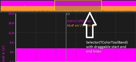

I am using TColorBandTool as a special data selector on my chart. It looks like a resizable yellow rectangle (start and end lines are allowed to be dragged). That rectangle can be any size now ( depends upon values StartValue, EndValue) but I would like to limit that.
My question is if it's possible to limit band width in a simple way?
Let's say I would like to limit band width to 10px (10px between StartValue and EndValue). I expect that whenever I drag one side of it, it will stop resizing when it reaches minimum size of 10px and it will continue resizing when size will be greater than that.

You could use the events to force that. Ie:
var draggingStart, draggingEnd: boolean;
procedure TForm1.ChartTool1Resizing(Sender: TObject);
var tmp: Double;
  tmp:=Chart1.Axes.Bottom.CalcPosPoint(10)-Chart1.Axes.Bottom.CalcPosPoint(0);
  if (Chart1.Axes.Bottom.CalcSizeValue(ChartTool1.StartValue, ChartTool1.EndValue) > 10) then
    if draggingStart then
      ChartTool1.StartValue:=ChartTool1.EndValue-tmp;
    if draggingEnd then
      ChartTool1.EndValue:=ChartTool1.StartValue+tmp;
  draggingStart:=false;
  draggingEnd:=false;
  ChartTool1.StartLine.OnBeginDragLine:=StartLineBeginDragging;
  ChartTool1.StartLine.OnEndDragLine:=StartLineEndDragging;
  ChartTool1.EndLine.OnBeginDragLine:=EndLineBeginDragging;
  ChartTool1.EndLine.OnEndDragLine:=EndLineEndDragging;
procedure TForm1.StartLineBeginDragging(Sender: TColorLineTool);
  draggingStart:=true;
procedure TForm1.StartLineEndDragging(Sender: TColorLineTool);
procedure TForm1.EndLineBeginDragging(Sender: TColorLineTool);
  draggingEnd:=true;
procedure TForm1.EndLineEndDragging(Sender: TColorLineTool);
  draggingEnd:=false;

thanks for fast response. Your solution helped me a lot. It's still not exactly what I was looking for but the idea and approach helped me to develop my solution.
