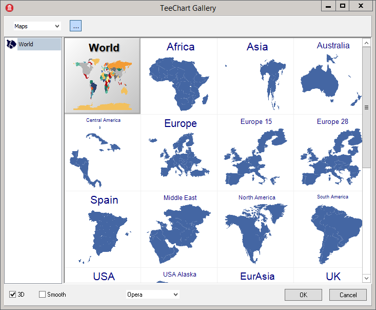

Post by Yeray » Mon Jul 13, 2015 11:00 am
Using the alternate gallery in TeeChart v2015.15 for XE7 I find the World series under the "Maps" section:

Re: TWorldSeries not available anymore
Post by Yeray » Tue Jul 14, 2015 9:19 am
Hello Jens,
I'm afraid the "Maps" section can be accessed in the gallery from v2015.14.
However, you can still add the TWorldSeries at runtime in v2014.12:
uses TeeWorldSeries;
var Series1: TWorldSeries;
  Series1:=Chart1.AddSeries(TWorldSeries) as TWorldSeries;
  Series1.FillSampleValues();
