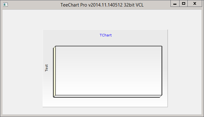

I setup a chart to use multiple lines on the left axis--but it is not working.
For example, in an otherwise new project with a TChart on the form, the following LOC:
Chart1.LeftAxis.Title.Caption := 'Test'#13'This'
Will only show "Test" on the left axis.
Is there anyway to get that to work? I looked at various left axis .title properties and didn't see anything there.

Hi Ed,
We've tried it here a simple example project with a series and the code you've posted and it seems to work fine for us here in two different machines.
Maybe there's a combination of properties that ends reproducing this. Could you please arrange a simple example project we can run as-is to reproduce the problem here?
Also, it would be helpful if you could indicate what OS, IDE and TeeChart version you are using.

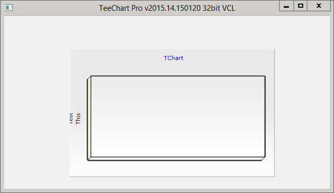

I could reproduce the problem with v2014.11 but it seems to work fine with v2015.14:

Post by TestAlways » Tue Jan 27, 2015 3:14 pm
Thank you. Yes, it does work correctly in 2015.14. Thank you.
