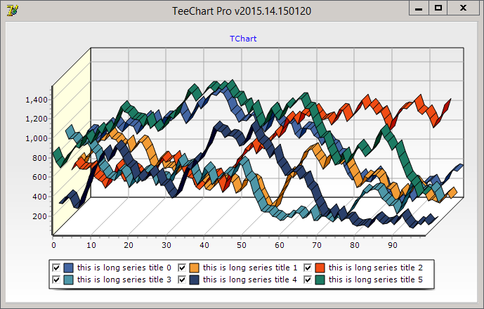

Re: Wrond legend display with 2015.14 update
Hello Yeray,
I'm very sorry but the bottom legend is still wrong.
I need to use a legend with checkboxes.
In my own program I get now the legend displayed correctly but get a wrong behaviour. So a click on some checkboxes switches on/off the wrong series. To switch on/off a desired series I need to click beside a checkbox in the legend text. This means that the mouse position is not calculated correctly.
As it is difficult to send the full source code I have tried to make an example. The example also behaves wrongly but a bit different (some checkboxes are missed but you can click also on the text). Anyway you can see a malfunction and check what's wrong.
So simply drop a TChart component on a project form and run
As I like to deploy a correct version of my program a quick fixup would be very appreciated.
- Uli
Hi Uli,
I've tried this with both v2015.14 and with the current internal sources we have here and it seems to work fine in both:
Here it is the project I used: Am I missing anything?
Hello Yeray,
I have downloaded your test project testBottomLegendCheckboxes.zip
Indeed it works with 3D display. BUT please switch 3D off and you get
Uli
Uli
